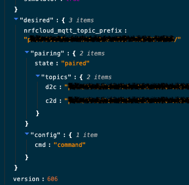

    When the device comes online and sends an empty message to  $aws/things/${deviceId}/shadow/get it gets a shadow back, but that shadow does not contain the pending delta, even though the delta is pending in the cloud:
    i.e. a cloud API FetchDevice shows
     "state": {
    "desired": {
    "nrfcloud_mqtt_topic_prefix": "prod/...",
    "pairing": {
    "state": "paired",
    "topics": {
    "d2c": "prod/.../d2c",
    "c2d": "prod/.../m/d/devsim4/+/r"
    "config": {
    "cmd": "command26"

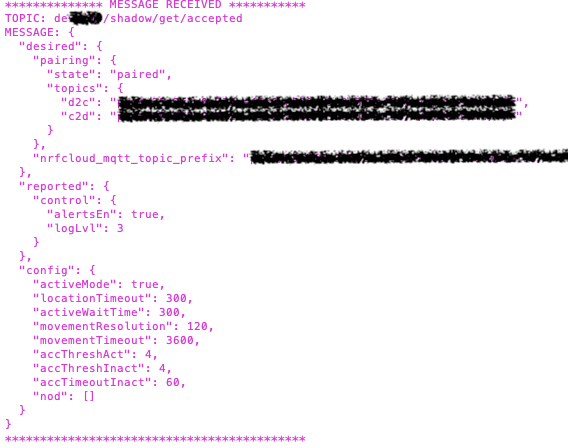

    but the shadow received via ${deviceId}/shadow/get/accepted shows the following (note that the pending delta "config" is missing:
      "desired": {
        "nrfcloud_mqtt_topic_prefix": "prod/.../"
        "pairing": {
          "state": "paired",
          "topics": {
            "c2d": "prod/.../+/r"

    I think I finally have some insight. I think the nRF Cloud incorrectly trims away parts of the desired section, whereas AWS doesn't.
    Here is what I did:
    1. The previous reported state of the device is {"cmd": "sendReport": "7"}
    2. The device is offline
    3. I send the desired update to the server {"cmd": "sendReport": "8"}
    4. When the device comes online it gets the shadow via ${deviceId}/shadow/get/accepted.
    The shadow shows config {"cmd": "sendReport": "7"} but is missing desired {"cmd": "sendReport": "8"}:
    ************** MESSAGE RECEIVED ***********
    TOPIC: devsim4/shadow/get/accepted
    MESSAGE: {
      "desired": {
        "pairing": {
          "state": "paired",
          "topics": {
            "d2c": "...",
            "c2d": "..."
        "nrfcloud_mqtt_topic_prefix": "..."
      "reported": {
        "control": {
          "alertsEn": true,
          "logLvl": 3
      "config": {
        "cmd": {
          "sendReport": "7"

    It looks like the nRF cloud ${deviceId}/shadow/get/accepted trims the desired delta, regardless of whether the device received it (i.e. was offline) or reported (cleared) it.
    This does not look right. Why is the config section of desired trimmed away by nRF Cloud? What is the correct way to do this?

  • Hello
    You are right, the nRF Cloud trims the config from the shadow.
    There is now a BETA feature in production for you to try out. Unfortunately I have not been able to test this yet, so only "copy and pasting" instructions for you.
    There are now new topics:
    subscribe "{deviceId}/shadow/get/accepted/tf" to receive the transformed subset of the devices full shadow (response to `.../get/tf`). See (3)
    Publish to "{deviceId}/shadow/get/tf" to request a subset of the devices full shadow, defined by a transform.
    Transformation example
    The required 't' property defines the transform string or JSON object.
    The optional 'l' property defines the payload size limit (500 bytes in this example):
    {'t':'state.desired.config', 'l': 500}
    The transformation is used in REST side and you can check https://docs.nordicsemi.com/bundle/nrf-cloud/page/APIs/REST/Tutorials/Transforms.html
    This should enable you to get only the parts you need with the get/tf.
