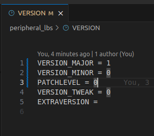

Bug in version_app.cmake
There is a bug in ncs\v2.7.99-cs2\nrf\cmake\version_app.cmake
add_custom_command(
OUTPUT ${PROJECT_BINARY_DIR}/include/generated/app_commit.h
COMMAND ${CMAKE_COMMAND} -DZEPHYR_BASE=${ZEPHYR_BASE} -DNRF_DIR=${NRF_DIR}
-DOUT_FILE=${PROJECT_BINARY_DIR}/include/generated/app_commit.h
-DCOMMIT_TYPE=APP
-DCOMMIT_PATH=${CMAKE_SOURCE_DIR}
-P ${ZEPHYR_NRF_MODULE_DIR}/cmake/gen_commit_h.cmake
DEPENDS ${CMAKE_SOURCE_DIR}/VERSION ${APP_GIT_INDEX}
should be
DEPENDS ${APPLICATION_SOURCE_DIR}/VERSION ${APP_GIT_INDEX}
