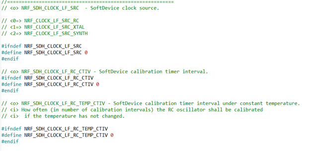

    From what I can see, the ANNA-B402 does not have a 32.768 kHz crystall mounted. That is OK, but the SDK exmaples are configured for a crystal, so you need to modify the project's sdk_config.h as explained in this post to use the internal LFRC instead.

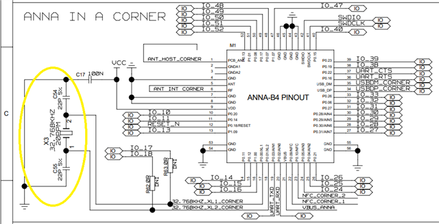

    I have checked schematic and board of ANNA-B402 EVK that I am using has external 32.768KHz crystal. Checked individually for both LFRC and XTAL settings in sdk_config.h, no BLE advertised to NRF connect on mobile or on Laptop.

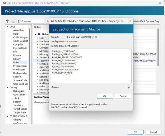

    Here is a screenshot of the section placement macros:
    Could you please point me to something that I may be missing to configure.

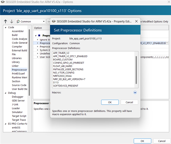

    If you are just trying to run the sample on the board there is no need to adjsut the section placement macros. Use the onces from the unmodified example. However, I suspect you are looking for the preprocessor defines? These are set under "Preprosessor" which is one step down in the menue from "Linker", where you are in this screenshot.
    I would suggest that you try the beacon sample first. This does not use any GPIO's, so as long as the LF clock configuration is correct it will work on any board even if you build with the DK board file. I did not find a clear indication that the EVK has the crystal in place, but the module does not. As using the internal LFRC will work regardless I suggest you test with that first as shown in my previous post. With this change, it should run on any board.

    this is the screenshot for preprocessor defines under "common" configuration:
    Preprocessor defines
    this is the screenshot for config_sdk.h setting for clock source:
    According to schematic of EVK ANNA B402, external crystal of 32.768KHz is present, also checked on the EVK ANNA B402 PCB it is present. However as suggested by you, I have used internal crystal LFRC as shown in the config_sdk.h file setting above.
    https://content.u-blox.com/sites/default/files/EVK-ANNA-B4_UserGuide_UBX-21008123.pdf
