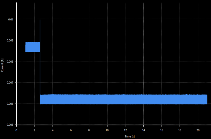

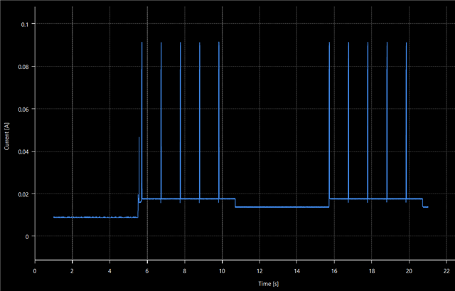

  • Hello, yes I was talking about idle current. In the image attached it is possiblle to visualize the current consumption chart. Before any thread or pheripheral initialization I put the system to sleep for 5 seconds (using k_msleep function) and the idle current is about 8.8mA. Then a thread starts running, for another 5 seconds, where the consumption rises and after that the system goes go sleep for 5 more seconds, where the idle consumption is about 13.5mA.
    Is there any way to improve this? I really don´t get how to achieve such low currents in the order of micro amps (uA) as you are saying.
    These are extremely high numbers for idle and I suspect there is either somethign else on your board drawing power (or a measurement issue), so we need to get an overview first.

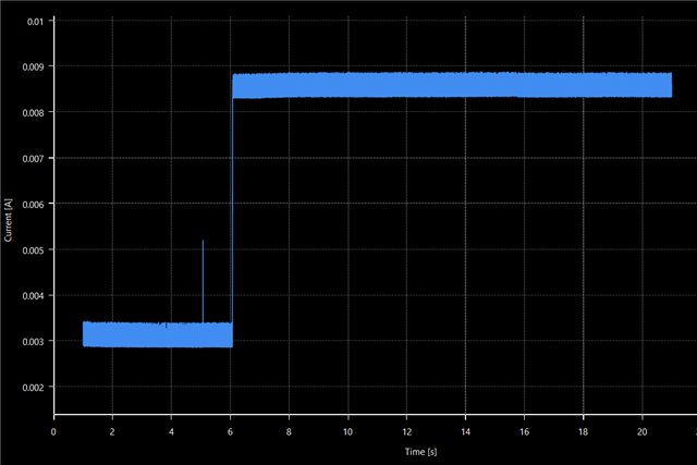

    Today, I ran the same test with both the NFC and CAN modules disconnected to see if there would be any difference. Here are the results: the current draw was approximately 3 mA before system initialization and around 9 mA when threads were running.

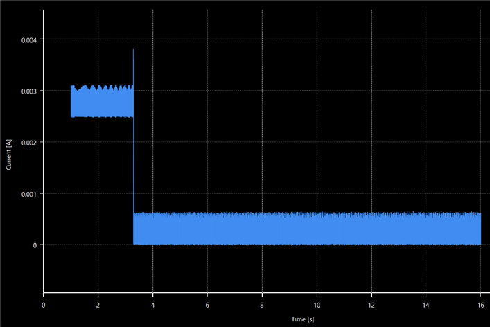

    I have performed the tests you have required and I goit the following results: without any external hardware connected I got currents between few micro amps until 500uA (the graph has a lot of noise) which seems a great improvement. With the hardware connected I got around 6mA which seems also acceptable. I am using the ST X-NUCLEO-NFC08A1 reader, if it is useful for you.
    This is more in line with what I would epxect and it points to the additional current draw coming from the external cuircuitry (which as mentionne dbefore it ahs to be, becasue it is difficult to get the nRF to consume 20 mA unless you are really trying).
