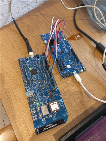

I want to connect my nRF9160DK board to my nRF7002DK board and get a wi-fi location. I've followed samples/cellular/nrf_cloud_multi_service as sample and I made wiring as follows
Board nRF9160-DK(P3 & P4) nRF7002-DK (P24)
SPI CLK P0.13 P0.17
SPI CS P0.10 P0.18
SPI MOSI P0.11 P0.13
SPI MISO P0.12 P0.14
HOST-IRQ  P0.07 P0.23
IOVDD-CTR  P0.00 P0.31
BUCKEN P0.01 P0.12

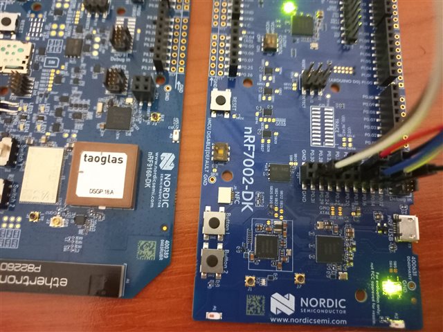

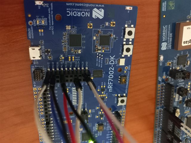

I soldered SB25 and SB20 on the nRF7002 board.

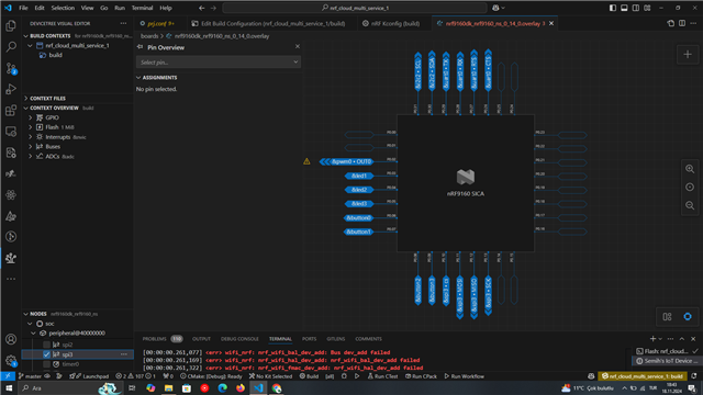

Then progress stops completely. The error changes when I disconnect any of the cables, so I thought the problem might be the configuration on the devicetree. and here how it looks like:
I tried to assign SPI WAKE to P0.07, the HOST-IRQ pin, but this time it started to give this error serially: ASSERTION FAIL @ WEST_TOPDIR/modules/hal/nordic/nrfx/drivers/src/nrfx_gpiote.c:486
    nRF7002 companion IC documentation specifies that control signal are available on P24 while QSPI is not connected by default. Connection to P24 can be established by shorting solder bridges from SB20 to SB25, not just SB20 and SB25. This is also specified in the nRF7002-dk solder bridge documentation.
