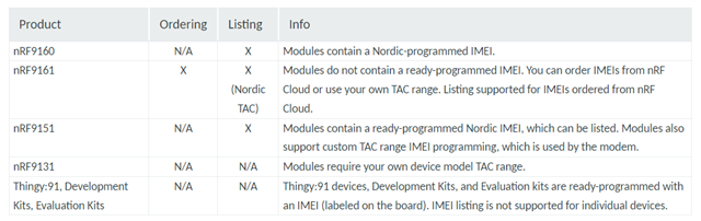

  • Doug K said:
    What does it mean for the nRF9151 module for "Modules contain a ready-programmed Nordic IMEI"?
    nRF9161 SiPs (also nRF9131) don't have an IMEI programmed (except for the DKs). You have to always order your own (via for example nRF Cloud).
    nRF9151 (and nRF9160) by default have IMEI programmed. Those IMEIs are registered under Nordic Semiconductor's TAC range, so they are ready to use out of the box.
    Michal
