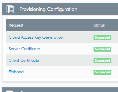

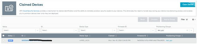

I'm trying to use the nRF Cloud Provisioning Service with the nRF Cloud multi-service sample in SDK 2.6 on a nRF9151DK.
I have got the token from the device using AT%ATTESTTOKEN and claimed the device in nRF Cloud
Then I compiled the sample with
-DEXTRA_CONF_FILE="overlay-http_nrf_provisioning.conf"
But the provisioning is not ok...What am I missing?
[00:00:00.256,439] <inf> spi_nor: gd25wb256e3ir@1: 32 MiBy flash
*** Booting nRF Connect SDK v3.5.99-ncs1 ***
[00:00:00.259,643] <inf> main: iAMP-Hydro has started, version: 1.0.2, protocol: MQTT
[00:00:00.259,704] <inf> cloud_connection: Enabling connectivity...
[00:00:00.544,769] <inf> cloud_connection: Setting up nRF Cloud library...
[00:00:00.725,860] <inf> cloud_connection: Waiting for network ready...
[00:00:05.010,375] <inf> cloud_connection: Network connectivity gained!
[00:00:06.010,589] <inf> cloud_provisioning: Initializing the nRF Provisioning library...
[00:00:06.010,833] <inf> cloud_connection: Network is ready
[00:00:07.050,079] <inf> cloud_provisioning: Provisioning is active.
[00:00:07.152,038] <inf> nrf_provisioning_http: Requesting commands
[00:00:09.535,980] <inf> nrf_provisioning_http: Connected
[00:00:09.536,010] <inf> nrf_provisioning_http: No more commands to process on server side
[00:00:14.536,102] <inf> cloud_provisioning: Provisioning is idle.
[00:00:14.536,163] <inf> cloud_connection: Connecting to nRF Cloud
[00:00:14.536,224] <inf> cloud_connection: Device ID: 50333648-3230-48f5-xxxx-xxxxxxxxxxx
[00:00:18.436,676] <err> nrf_cloud_transport: MQTT input error: -128
[00:00:18.436,737] <err> nrf_cloud_transport: Error disconnecting from cloud: -128
[00:00:18.436,798] <inf> cloud_connection: Disconnecting from nRF Cloud
[00:00:18.436,828] <err> cloud_connection: Could not connect to nRF Cloud
[00:00:18.436,828] <inf> cloud_connection: Retrying in 30 seconds...

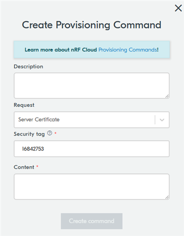

    I have a nRF9151DK that I provisioned using DeviceID and Pin. I tried the same with a custom board using DeviceID and HWID, but got this error:
    Is it possible to provision custom boards this way? If so, why the error? Do I need to download a certificate, or is it present in all nrf9151 SOC's?
  • To use Device ID and PIN, you need to use JITP to onboard the device. That is a different process than the Auto-Onboarding, and you should only do one or the other.
    A DK already comes with JITP done by Nordic, whereas for your own custom board, you have to do that yourself. JITP is not the recommended way for mass production, you should use either Auto-Onboarding or Preconnect onboarding.
