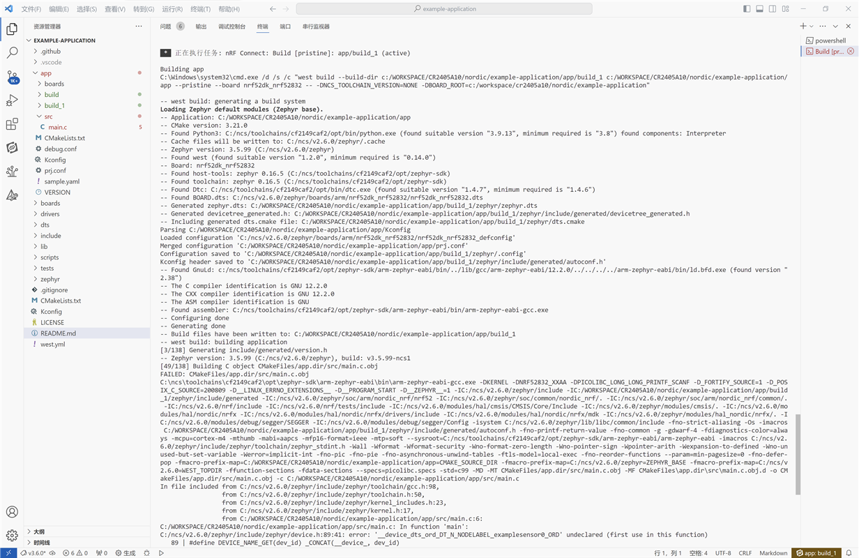

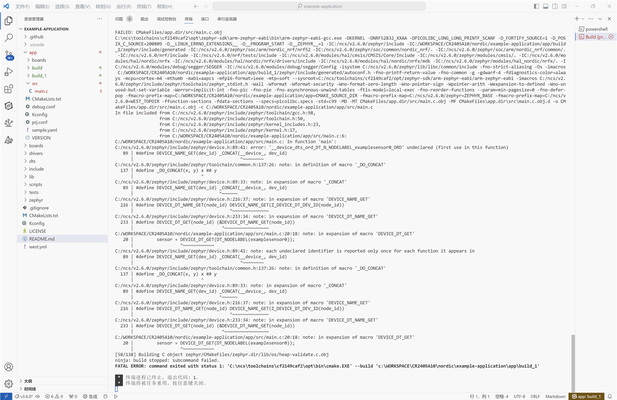

I want to connect LDC2114 to nRF9160. I write the nrf9160dk_nrf9160_ns.overlay and the astri,ldc2114.yaml. I don't know how to set GPIOs in &i2c1 - ldc2114: ldc2114@2a which are the output pins of LDC2114 and input pins of nRF9160.

Also, What else should I do in order to connect the devices?
