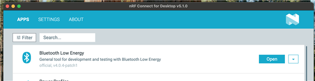

    It says you are using pc-nrfconnect-ble v4.0.4 official, while I see that I have installed a version called "official, v4.0.4-patch1":
    Although it doesn't print the version in the log when I open it. Can you check if there are any updates available, and if so, try to update the nRF Connect for Desktop Bluetooth Low Energy Standalone app? Under the nRF Connect for Desktop, there is a settings tab, where you can click Check for Updates:
    Can you do that, and make sure that you have the latest version installed?

  • Hi Edvin,
    in nRF Connect for Desktop it also says on my side, that "official, v4.0.4-patch1" is installed, while nRF Connect for Desktop Bluetooth Low Energy says, it is version v4.0.4.
