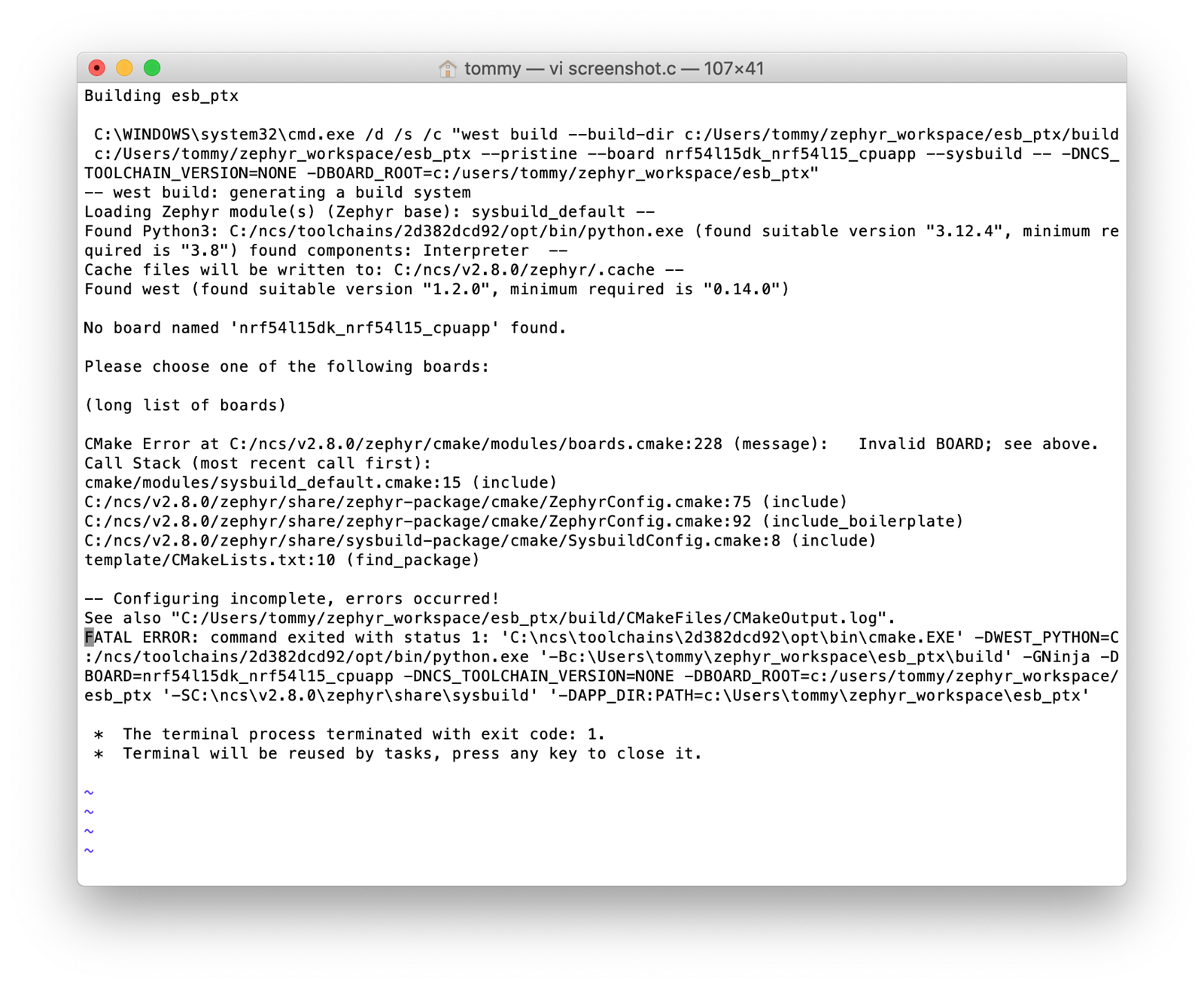

I tried to build with nrf54l15dk_nrf54l15_cpuapp selected as the board in the "Add Build Configuration" window, I pretty quickly get error message:
" CMake Error at C:/ncs/v2.8.0/zephyr/cmake/modules/boards.cmake:228 (message):
  Invalid BOARD; see above. "
I scrolled above in the terminal output and was able to find among the hundred's of supported boards listed, it did include nrf54l15dk .
What am I missing ?

    Could you share the full error output?
    With hardware model v2 (HWMv2), the correct board name should be nrf54l15dk/nrf54l15/cpuapp.
    underscores in the board name will create a error:

    My build output is:
    No board named 'nrf54l15dk_nrf54l15_cpuapp' found.
    Please choose one of the following boards:
    ...long list of boards..
      C:/ncs/v2.8.0/zephyr/cmake/modules/zephyr_default.cmake:133 (include)
      C:/ncs/v2.8.0/zephyr/share/zephyr-package/cmake/ZephyrConfig.cmake:66 (include)
      C:/ncs/v2.8.0/zephyr/share/zephyr-package/cmake/ZephyrConfig.cmake:92 (include_boilerplate)
      CMakeLists.txt:8 (find_package)
    Tommy Schell
    Thomas_E said:
    There is no option in the Boards listing for "nrf54l15dk/nrf54l15/cpuapp" .  Only "nrf54l15dk_nrf54l15_cpuapp" .
    Can you share a picture of your vs code setup, while in the "Add build configuration" tab?
    If $board_$device is the only option to select, this indicates a setup related issue. For instance that vscode picks up the wrong NCS version or similar.
    Are you on mac or windows? Screenshot indicates mac, while log indicates windows.
    Håkon
  • Hi again, I am on Windows 11.  As a side note, if I try to build targeting the nrf52840 DK board, as part of the output I see:
    CMake Warning at C:/ncs/v2.8.0/zephyr/cmake/modules/boards.cmake:110 (message):
      Deprecated BOARD=nrf52840dk_nrf52840 specified, board automatically changed
      to: nrf52840dk/nrf52840.
    -- Board: nrf52840dk, qualifiers: nrf52840
    And then it successfully builds.
    Here is the screenshot with nrf54L15 DK selected:  (again, no options for any boards in the list with "/" in place of "_"  as the name separator)
    Thanks
  • My extensions (nRF Connect for VS Code, etc) were out of date, that's the problem.  I had Auto-Update turned on for the extensions but I usually have my Windows dis-connected from the network at boot-up, to avoid Windows background stuff that bogs everything down.  I just turn on the network selectively as needed.  I had updated the SDK and toolchain but didn't think about the extensions.  So that I kept missing the Auto-Updates, unwittingly.  My mistake !  Sorry to trouble you !
