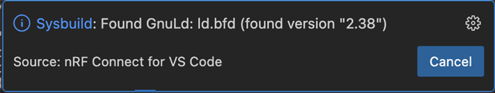

Previously, nRF Connect SDK was working without issue. However, now when I try to create a new build configuration, it hangs at the following step:
It's unclear why this began happening, it was working fine before and occurred in the middle of a session where build configurations had been created successfully several times.
Although I can't create new build configurations, I can still build and flash existing configurations as normal.
This error has happened many times before, but usually is fixed by restarting VS Code. However, this solution is no longer working. I also tried restarting my computer but it didn't help.
I'm aware a similar ticket was raised here but this thread doesn't provide a fix. When using the command line solution provided in the original post, it still hangs at the Gnuld step.

  • Hello, the issue has reappeared. I think the sequence that makes it happen is:
    1) Have VS Code window open with nRF Connect SDK, with at least one application which has an existing build configuration open.
    2) Open new VS Code window. Either create new nRF Connect SDK application or open existing application in this new window.
    3) Application appears to have no build configurations, so you are prompted to create one by clicking on "Add build configuration".
    4) Compiler hangs at "Gnu ld" step as described above.
    Here is the build log (for the GATT DM example):

    -- Found GnuLd: /opt/nordic/ncs/toolchains/15b490767d/opt/zephyr-sdk/arm-zephyr-eabi/arm-zephyr-eabi/bin/ld.bfd (found version "2.38")
    There is no error message, the compiler simply hangs at this step. I have sent you the support information via private message.
