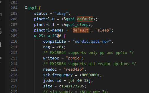

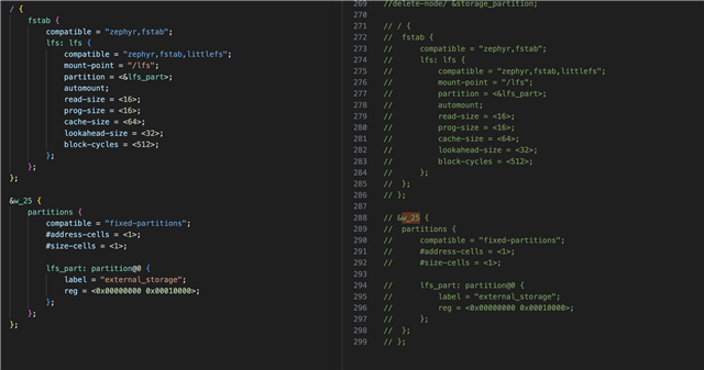

    I should have clarified - the sections in the linked DTS files are where I believe the partitions are being declared on the external device. See the screenshot.
    I've narrowed down the problem further, though. Using the DTS file named v5_0_prod_board_narrowed.dts in the zip below, the no-boot condition occurs when the line
    "nordic,pm-ext-flash = &w_25" is not commented. Commenting this line allows the application and bootloader to work as expected.

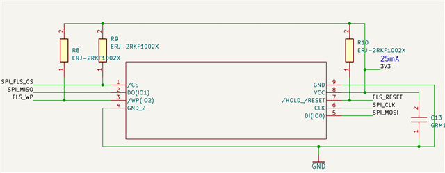

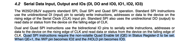

    -- The flash chip I'm using will switch the functionality of one pin from HOLD or RESET to IO3 when configured with a certain register to use QSPI instead of the default SPI. I'm not sure whether the QSPI driver is able to account for this, so to be sure I eliminated this as a variable. I assume if this register is not configured, any attempt at a transaction that would switch the state of this pin would result in the chip being reset / blocked for further transactions. Can you point me to where I can edit the driver for the flash chip if this functionality is not added by default?

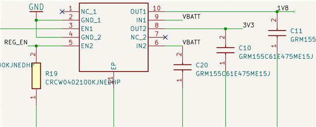

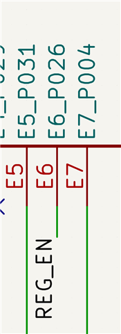

    - I must reset the board while manually applying voltage to the rail powering the flash chip - it appears that, even though the vin-supply is added to the DT, whatever driver(?) is active in the bootloader does NOT enable the regulator. I consistently need to manually apply power to the flash chip's VDD in order for the application to run. Is there a way to make sure that the bootloader enables the regulator before attempting any flash transactions? What about for the QSPI driver, which does not have this property?
