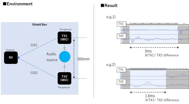

nRF5340, Audio transmission delay between 2 peripherals (Tx1 and Tx2)
We could have found "transmission delay" in 2ch Audio recording sequence.
Here are the detail about the environment of DUT, and phenomenon.
Please find the attached file.
Would it be possible to let us know the possible cause of this delay?
We are using ver2.3.0 as NCS.
In addition, this phenomenon has been found in our pre-production model.
And if you can suggest any test environment provided by nordic's EVK to immitate, it would be highly appreciated.
BR,
4353.TX1TX2_difference.pptx

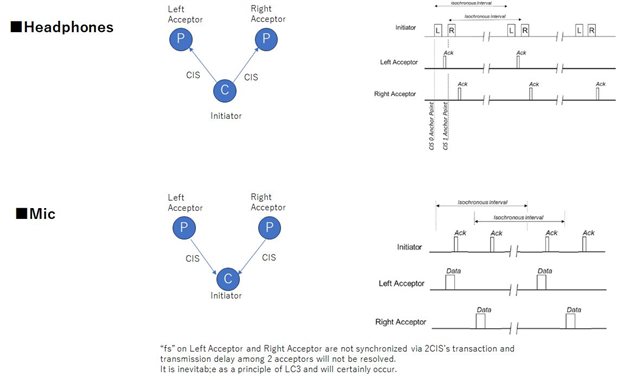

    I just had a discussion with our R&D and was informed that this has already been discussed directly with them.. In short, we don't have synchronization mechanism for L and R send back to the central.. Synchronization only happens on the headset side.. It was informed to us that Canon will upgrade the SDK shortly.. But even then, this is a missing feature.
    Best Regards,
    Swathy
  • Thanks SwRa.
    Here is my understanding, is it right?
    “fs” on Left Acceptor and Right Acceptor are not synchronized via 2CIS’s transaction and transmission delay among 2 acceptors will not be resolved.
    It is inevitab;e as a principle of LC3 and will certainly occur.
    Swathy is out of the office, so I picked up this case.
    As Swathy gets from the developer: we don't have a synchronization mechanism for L and R to send back to the central. Synchronization only happens on the headset side.
    Your NCS version is a bit old. Could you test again with the latest version, v2.8.0?
    -Amanda H.
  • Amanda,
    Thank you for your supprt.
    I understood that the wireless communication can be synchronized by ISO_Interval.
    (And I think this issue surely occur regardless of the version.)
    The each of the two microphones will occur individual clock drift for sampling frequency as 48kHz or 96kHz and as a result the audio from the two microphones will not be exactly synchronized.
    Actually, this is a slight delay(the order is msec or usec), but in some cases such as a professional video recording, it's keen to minimize it.
    If there is no way to sync, we would like to even assure maximum, minimum value of this delay.
    Can you provide quantitive value for nrf5340?
    And if there is a way to solve, we think one of the solution is to use RTC (Real-Time Clock) synchronization between TX and RX by BT command.
