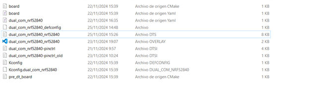

  • Hi, I’d like to add to this discussion that I’m facing the same issue. I created a custom board named dual_com_nrf52840. To open it with the devicetree, I have to add the board name again. I recently upgraded to version 2.8.0.
  • Hi Julen, thanks for chiming in.
    Where did you add the board name again? I am not sure if I understand.
    Did you follow the DevAcademy course on this?
    Elfving
