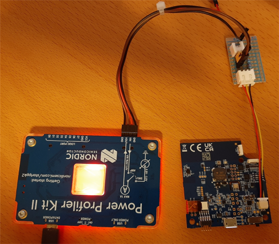

  • In my experience, the easiest way is to use a JST 1mm 3pin wire. You will find them in several web-shops.

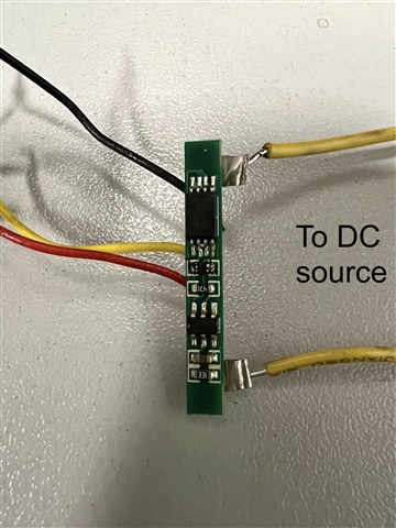

    Following the suggestion, I disconnected the battery from the board (connected via a JST 3-pin wire) and supplied a 3.7V DC source through the P3 port. While monitoring the current consumed by the board, I noticed fluctuations between 5 mA and 30 mA. However, I expected the board to use higher current, with noticeable spikes if it were functioning as intended.
    I’m using this module to log temperature readings to Microsoft Azure Cloud, but the board remained unresponsive, cycling through this 5 mA to 30 mA range without taking any action.
    Thinking the board might require a 3-terminal input (similar to the JST 3-pin battery connection), I removed the small PCB attached to the battery (I’m unclear on the purpose of this PCB—please see the attached photo for reference). I then directly connected the two battery terminals to the DC source, but the issue persisted, and it just used an almost constant current of around 20 mA.
    Interestingly, when I reconnected the battery, the module resumed its normal operation, successfully logging temperature readings to the cloud.
    This behavior is puzzling, as I’m unsure if I made an error in the connection process or if there’s a different approach I should try. Could you clarify why the P3 port did not function as expected, why connecting the DC source to the battery port didn’t work, and whether there's a specific way to connect the DC source to ensure proper operation?
    Looking forward to your insights.
    Roshan
  • Hi Achim,
    Thank you for the suggestion! Could you please clarify how the signal port of the JST connector should be handled? Should it be left floating? I tried leaving it unconnected, and while the Thingy:91 powered up, it didn’t seem to search for an LTE signal or attempt to send one.
  • The JST connector has GND, temp sensor, VAT.
    What is the "signal part"? The temp sensor? I use a 10k resistor to GND. AFAIK, that's only required, if the battery is replaced by an other battery.
    Interesting. Maybe I find some time to retest it, but in my memory, it's not required to connect the temp. sensor.
    From other tickets (and my experience), if LTE doesn't work, your power supply is too weak. How much current will that deliver? Go for at least 500mA.
