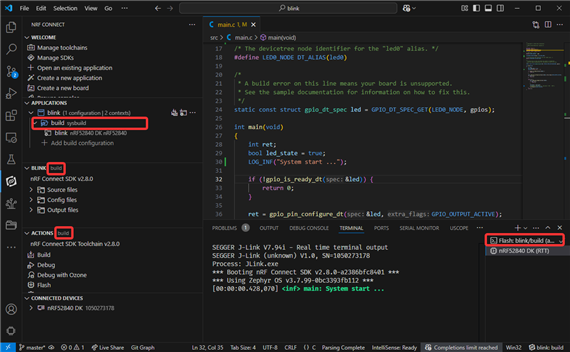

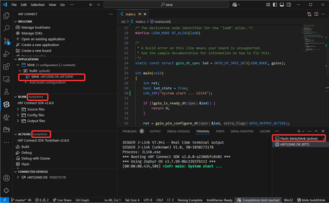

  • By chance, I have noticed more correlations of this problem.
    The behaviour depends on the application build selection, in the image i marked differences.
    In short:
    For correct:    Executing task: nRF Connect: Build: blink/build (active)
    For incorrect: Executing task: nRF Connect: Build: blink/blink (active)
    1. Correct behaviour:
      Logs:
       *  Executing task: nRF Connect: Build: blink/build (active)
      Building blink
      C:\Windows\system32\cmd /d /s /c "west build --build-dir d:/examples/blink/build d:/examples/blink"
      [0/5] Performing build step for 'blink'
      ninja: no work to do.
      [4/5] cmd /C "cd /D D:\examples\blink\build\_sysbuild && C:\ncs\toolchains\2d382dcd92\opt\bin\cmake.exe -E true"
       *  Executing task: nRF Connect: Flash: blink/build (active)
      Flashing build to nRF52840 DK
      C:\Windows\system32\cmd /d /s /c "west flash -d d:\examples\blink\build --skip-rebuild --dev-id 1050273178"
      -- west flash: using runner nrfjprog
      -- runners.nrfjprog: reset after flashing requested
      -- runners.nrfjprog: Flashing file: D:\examples\blink\build\merged.hex
      [ #################### ]   1.092s | Erase file - Done erasing
      [ #################### ]   0.221s | Program file - Done programming
      [ #################### ]   0.220s | Verify file - Done verifying
      Enabling pin reset.
      Applying pin reset.
      -- runners.nrfjprog: Board with serial number 1050273178 flashed successfully.
    2. Wrong behaviour:
      Logs:
       *  Executing task: nRF Connect: Build: blink/blink (active)
      Building blink
      C:\Windows\system32\cmd /d /s /c "west build --build-dir d:/examples/blink/build/blink d:/examples/blink"
      [7/7] Linking C executable zephyr\zephyr.elf
                 FLASH:       32664 B         1 MB      3.12%
                   RAM:       25536 B       256 KB      9.74%
              IDT_LIST:          0 GB        32 KB      0.00%
      Generating files from D:/examples/blink/build/blink/zephyr/zephyr.elf for board: nrf52840dk
       *  Executing task: nRF Connect: Flash: blink/blink (active)
      Flashing blink to nRF52840 DK
      C:\Windows\system32\cmd /d /s /c "west flash -d d:\examples\blink\build\blink --skip-rebuild --dev-id 1050273178"
      [ #################### ]   1.099s | Erase file - Done erasing
      [ #################### ]   0.228s | Program file - Done programming
      [ #################### ]   0.219s | Verify file - Done verifying
      Enabling pin reset.
      Applying pin reset.
      In this case i can obtain the behaviour what i describe in previous post.
  • Hello, and thanks for your patience with this issue.
    The issues that you describe in this ticket are known, there will be a fix but I do not have a timeline at the moment.
    For the issue described in you last comment, the workaround, until a fix is introduced, is to manually select the sysbuild and then build.
