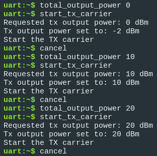

I then flashed my board with the radio test mode FW and sent commands for tx_output_power 0, 10, and 20. When I send start_tx_carrier at each output power setting, I can definitely see a difference so the FEM seems to be working, but is this power consumption in-line with expected values? If not, what could be going wrong?
At 0dBm: 4.75mA average current, 12.46mA max
At 10dBm: 6.57mA average current, 9.61mA max
At 20dBm: 6.59mA average current, 9.52mA max
