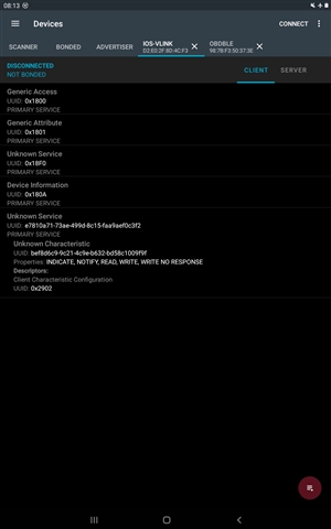

I attached an image of the service/characteristic from nRF52 connect.
I have another OBD device that uses 16 bit UUIDS and was able to do this easily, but since these use 128 bit UUIDs, I am running into some issues.

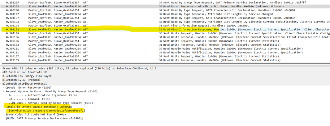

I have attached my wireshark capture from when I establish a connection, search for the service and then search for the characteristic for a working device and the non-working one. The LE Link Capture is working while the VLINK does not.

    What  I notice is that the service and characteristic doesn't have the same base UUID (service starting with 0xe781, and characteristic starting with 0xbef8), which may be causing the issues that you are seeing.

  • I agree with Edvin about the inconsistency of the base UUID which may lead to this issue. Thus, something wrong with the UUID setup in the central custom service.
    Basically, the central custom service has to look for the service UUID and characteristic UUID of the peripheral device.
    I did a primary service discovery with the VLINK device in the nRF52 firmware and only found 4 Primary Services, 0x1800, 0x1801, 0x18F0, and 0x180A. It never found the Unknown Primary Service (e7810a71-73ae-499d-8c15-faa9aef0c3f2). This is the service with the read and write characteristic.
    The base uuid should be used for different services (i.e., different service UUIDs). Make sure you use correct service UUID in your central custom BLE.
    Regarding the uuid type, you shouldn't assign it either BLE_UUID_TYPE_BLE or BLE_UUID_TYPE_VENDOR_BEGIN as it's supposed to detect by the central custom BLE. This info was obtained from the peripheral device. That's why you were trying to assign it, but it gave you a different return number.
    Edit1: Can you take a capture of nRF connect app in the case that you can use iOS app to read and write your peripheral device? You can show all services available and expand the one that allows you to notify/read/write.
  • This is from iOS wireshark capture, it even didn't detect ATT from this service UUID: e7810a71-73ae-499d-8c15-faa9aef0c3f2. Thus, I don't think it's a correct service that you were looking for to read/write to your peripheral device.
