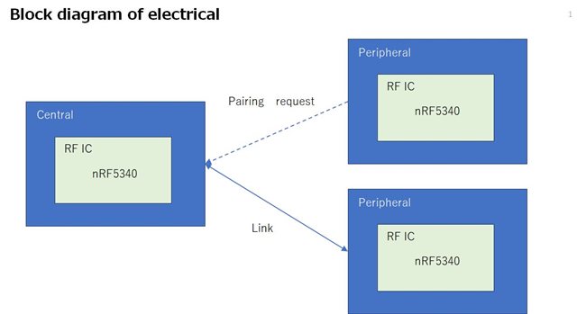

Regarding the behavior of pairing
In the pairing process among 1 Central and 2 Peripherals
Sometimes the Pairing  processing rarely does not work correctly and the following log output:
<err> cis_gateway: ACL connection to 4B:01:AA:9F:C4:2F (random) failed, error 2
Please find the attached ppt.
Would it be pssilbe to let us know what cause this problem?
