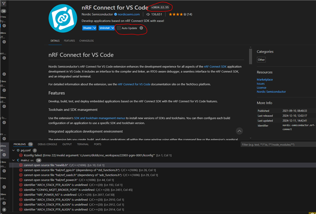

In every scenario, we get the same error in the problems tab on VS Code. If we manually build with a west command we can get it building, but it still seems to ignore some/all of the project configuration file. In the last attempt, we found that it built fine, did not show any errors on the terminal (still there on problems tab), but when it came to debugging, we could tell the config options had not been used.

    When I first started using the nRF9160, VS code was definitely supported. When you downloaded the SDK, there was a button that checked all the extensions you had on VS Code and it would prompt you to install them on VS Code if any were missing. V1.6.1 was the latest at the time, for sure, that why I went with it. There was a Youtube video showing this on this SDK at the time that I followed - looks like that video has been updated now.
    Can I also check how the build command would work if the sample was copied to a different location, rather than building in that sample folder? I wondered if it was something to do with build files not referencing the correct west or CMAKE directory, or just something missing - there is also a lot of environment variables that could be wrong I guess, but that's tricky to debug as they seem to exist all over the SDK folder
    Regarding deleting build folders and building pristine - trust me, we have done that hundreds of times.
    The point still stands that we need to get this in VS Code too, difficult to debug and step through code without an IDE.

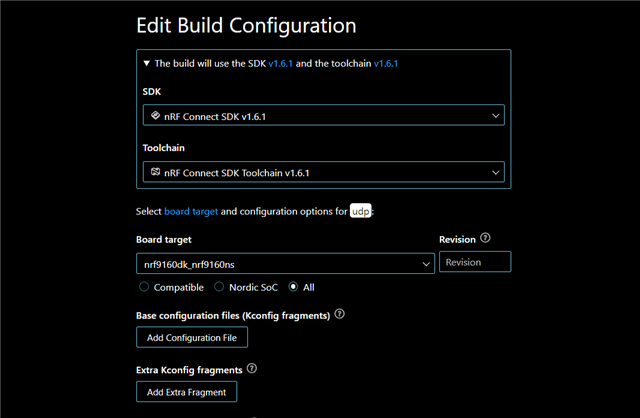

    nRF Connect Extension for VS Code has a update recently that allows developers to choose the version of the nRF Connect SDK and toolchain they wish to use.
    I downloaded the NCS v1.6.1 toolchain and NCS with the latest nRF Connect Extension for VS code. The installation is located in C:\ncs\v1.6.1.
    For testing, I copied the C:\ncs\v1.6.1\nrf\samples\nrf9160\udp sample project to C:/udp.
    I built both versions of the udp project using the following configuration, and both builds completed successfully without issues.
    Below is the log showing the build and programming process captured from the nRF Terminal when build C:/udp:

     *  Executing task: nRF Connect: Build: udp/build (active)
    Building udp
    C:\WINDOWS\system32\cmd.exe /d /s /c "west build --build-dir c:/udp/build c:/udp"
    [0/11] Performing build step for 'spm_subimage'
    ninja: no work to do.
     *  Executing task: nRF Connect: Flash: udp/build (active)
    Flashing build to 960014628
    C:\WINDOWS\system32\cmd.exe /d /s /c "west flash -d c:\udp\build --skip-rebuild --snr 960014628 --erase"
    -- west flash: using runner nrfjprog
    -- runners.nrfjprog: mass erase requested
    -- runners.nrfjprog: Flashing file: C:\udp\build\zephyr\merged.hex
    [ #################### ]   0.365s | Erase file - Done erasing
    [ #################### ]   0.883s | Program file - Done programming
    WARNING: A programming operation has been performed without --verify.
    WARNING: Programming can fail without error.
    Applying pin reset.
    -- runners.nrfjprog: Board with serial number 960014628 flashed successfully.
