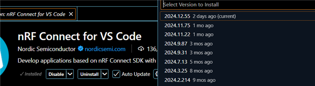

  • Here is the version of nRF Connect for VS Code extension I used.

  • Hi Again Charlie,
    So interestingly I just opened up VS Code and I now have all the same problems my colleague does. Which definitely makes me think VS Code and all the extensions have updated themselves. I remember something similar happened before and I turned off Auto-Update so I didn't have the same problems again.
    In fact you can see in this screenshot that Auto Update is off, yet I am on the latest update of the nRF Connect extension.
    Luckily, the latest revision of our firmware was released a couple days ago, so there isn't as urgent a need for this to be fixed as there would have been a week ago.
    Damien

    We’ve observed complaints about the VS Code Problems tab in the past. Most of the time, it can be confusing due to delayed updates or improper extension settings.
    Personally, I no longer focus much on its reporting, as long as building and debugging with the nRF Connect for VS Code extensions work as expected.
    Since support for NCS v1.x has been deprecated, I wouldn’t recommend spending too much time troubleshooting issues reported in the Problems tab or try to make it work properly.
    Charlie
