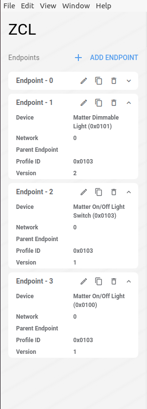

I am using nRF Connect SDK v2.7 + VsCode + NRF5340 DK and trying to add and extend matter-light-bulb sample. With 'MA-onofflight' when I try to compile the project it gives the following errors:

Invoked the zap tool using:
~/ncs/v2.7.0/modules/lib/matter/scripts/tools/zap/run_zaptool.sh $HOME/light_bulb/src/light_bulb.zap
Please see Endpoint-3 On/Off LIght

    The default matter-light-bulb samples without adding endpoint-3(MA-ONOFF Light) builds and compiles on my system but as soon as I add endpoint-3 the error messages appear.
    Please see my attached zap-file google-drive link. There I have attached both '.zap' and '.matter' files. Thank you.
    You need to run west zap-generate after you edit the .zap file. You can do this from the ZAP tool or from a terminal as shown in the link.

    Thank you very much. west zap-generate worked perfectly when using from $HOME/light_bulb i.e project directory.
