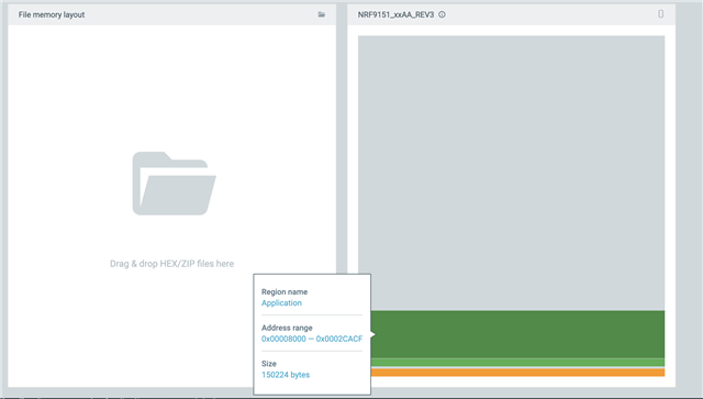

    2. Is there a tool which enables memory capacity overview of both processors in nRF9161 SoC? In other words, is it possible to check how much space is occupied / free within modem processor and within application processor?
    You can use the nRF Connect for Desktop and the Programmer app to read the current memory layout. In this case I've read the memory of the nRF9151
    Also, when building the application using our nRF Connect for VS code extension it will provide a memory usage overview.
