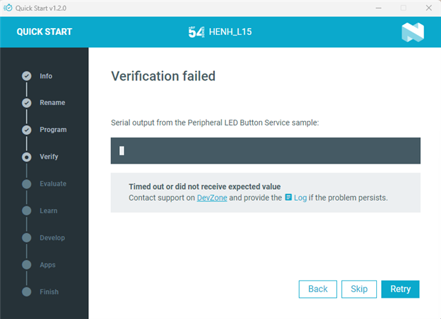

Using the nRF54L15 Development Board.
Did try to run the "nRF connect for desktop" - "Quick start"
I do not get a reply from the Board when doing one of the samples.

2024-12-10T09:42:45.854Z INFO Opened port with options: {"path":"COM7","baudRate":115200}
2024-12-10T09:42:51.139Z INFO Closed port: COM7
I earlier did a DTM test Image, and had the "Direct Test Mode" function work.
But later I did not success in getting any DTM build to work !
The Build is successful, but after flash (by visual studio code), the DTM application fail by
"cannot communicate with the device. Make Sure it is not in use by other application, that the correct serial port has been selected, and that it uses firmware with Direct Test Mode"
 I did also try to "recover" the board - same problem
    Which version of the nRF54L15 DK do you have?
    From v2.8.0 and upwards, you need to have 0.8.x or newer.

    Have you checked if there's any terminals open that is keeping the DTM from accessing the COM-port?
    Quick-Start for instance, this will grab the COM-port for logging purposes.

    The kit will enumerate two COM ports. Have you checked both COM ports when testing DTM?

    2024-12-13T10:17:10.539Z INFO Initialising the bundled nrfutil device
    2024-12-13T10:17:10.628Z DEBUG Application data folder: C:\Users\henh\AppData\Roaming\nrfconnect\pc-nrfconnect-dtm
    2024-12-13T10:17:10.669Z DEBUG Sending event "dtm: running nrfutil device"
    2024-12-13T10:17:10.669Z DEBUG App pc-nrfconnect-dtm v2.4.2 (official)
    2024-12-13T10:17:10.669Z DEBUG App path: C:\Users\henh\.nrfconnect-apps\node_modules\pc-nrfconnect-dtm
    2024-12-13T10:17:10.670Z DEBUG nRFConnect 5.1.0, required by the app is (>=5.0.1)
    2024-12-13T10:17:10.670Z DEBUG nRFConnect path: C:\Users\henh\AppData\Local\Programs\nrfconnect\resources\app.asar
    2024-12-13T10:17:10.670Z DEBUG HomeDir: C:\Users\henh
    2024-12-13T10:17:10.670Z DEBUG TmpDir: C:\Users\henh\AppData\Local\Temp
    2024-12-13T10:17:11.572Z DEBUG Sending event "dtm: running nrfutil device"
    2024-12-13T10:17:12.276Z DEBUG Sending event "dtm: running nrfutil device"
    2024-12-13T10:17:12.368Z DEBUG Sending event "dtm: running nrfutil device"
    2024-12-13T10:17:13.600Z INFO Getting serial port options from the persistent store for D30DF4955397.pc-nrfconnect-dtm
    2024-12-13T10:17:13.601Z INFO Getting serial port options from the persistent store for 001057731758.pc-nrfconnect-dtm
    2024-12-13T10:17:13.602Z DEBUG Sending event "dtm: device connected"
    2024-12-13T10:17:13.603Z DEBUG Sending event "dtm: device connected"
    2024-12-13T10:17:13.673Z INFO Using the bundled core version for nrfutil device: 7.13.0
    2024-12-13T10:17:14.041Z INFO Using nrfutil-device version: 2.6.4
    2024-12-13T10:17:14.041Z INFO Using nrf-device-lib version: 0.17.35
    2024-12-13T10:17:14.042Z INFO Using nrfjprog DLL version: 10.24.2
    2024-12-13T10:17:14.042Z INFO Using JLink version: JLink_V7.94i
    2024-12-13T10:17:15.481Z INFO Selecting device with the serial number 001057731758
    2024-12-13T10:17:15.560Z DEBUG Sending event "dtm: running nrfutil device"
    2024-12-13T10:17:17.405Z INFO Selected device with the serial number 001057731758
    2024-12-13T10:17:17.405Z INFO No firmware defined for selected device
    2024-12-13T10:17:17.405Z INFO Please make sure the device has been programmed with a supported firmware
    2024-12-13T10:17:17.406Z INFO Connected to device with the serial number 001057731758 and family: NRF54L_FAMILY
    2024-12-13T10:17:17.406Z INFO Note: no pre-compiled firmware is available for the selected device. You may still use the app if you have programmed the device with a compatible firmware.
    2024-12-13T10:17:17.406Z INFO Device selected successfully
    2024-12-13T10:17:17.407Z DEBUG Sending event "dtm: device selected"
    2024-12-13T10:17:18.673Z INFO Running device setup
    2024-12-13T10:17:18.673Z DEBUG DTM Transport: Create setup CMD with control: 0
    2024-12-13T10:17:18.673Z DEBUG DTM Transport: Create setup CMD with parameter: 0
    2024-12-13T10:17:18.673Z DEBUG DTM Transport: Create setup CMD with dc type: 00
    2024-12-13T10:17:18.686Z DEBUG DTM Transport: Serialport is opened
    2024-12-13T10:17:18.687Z DEBUG DTM Transport: Succeeded to open serialport
    2024-12-13T10:17:18.687Z DEBUG DTM Transport: Sending data: 0x00 0x00
    2024-12-13T10:17:19.690Z INFO DTM setup reset command failed
    2024-12-13T10:17:19.690Z INFO Cannot communicate with the device. Make sure it is not in use by another application, that the correct serial port has been selected, and that it uses firmware compatible with Direct Test Mode.
