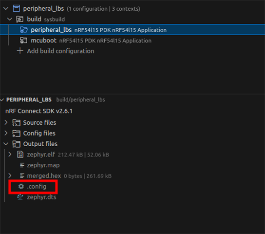

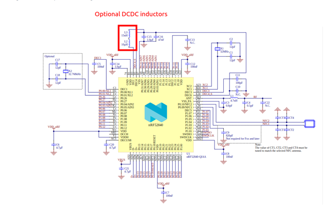

    CONFIG_BOARD_ENABLE_DCDC will reduce the peak currents if not enabled already (you can check if it is selected for your build by seeing if the symbol is seleced in the generated .config file). Note: make sure your board include the DCDC inductors before enabling this. Otherwise, the CPU will not receive a stable supply voltage.
    Generated configuration file:
    Do you have measuring equipment to measure the current waveform like the PPK2? It would help to know what idle current is.
  • Hi~
    Thanks for your detail answer, we do have this two DCDC inductors and not enable DCDC yet.
