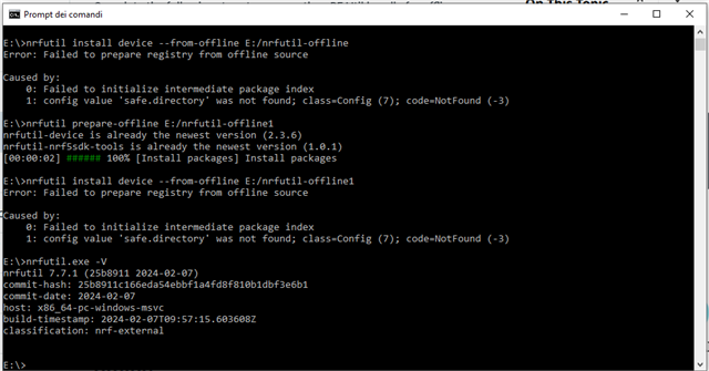

  • HI
    I tried with at least 4 USB sticks, always the same.
    I re-downloaded “nrfutil.exe” (again), put it in the USB stick where I unzipped your compressed file and attempted to install it on a physical Win10 machine, even with internet access this is the result:
    Then again on this machine I recreated my 'offline' package and tried to install it from a USB stick, this is what I got:
    I'll try to update the version on my PC and redo the package, but at this point I have little hope, I'll let you know then, but I'm afraid we're missing something...
