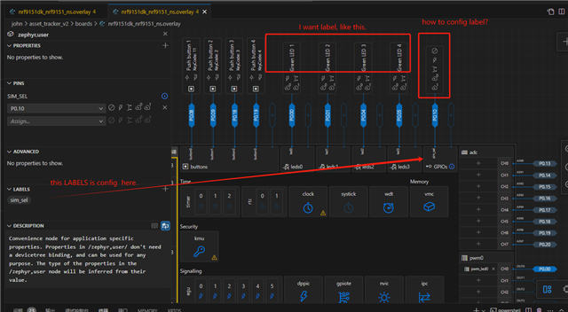

Hi:
I want to configure an IO, but I don't find the label.
Hi:

Although, I'm pretty sure you don't need either type of label to configure a GPIO.
Hi:
After I configure it like this:
Thank you for the feedback. I have forwarded it internally so that we can look at how labels are supported on generic GPIO pins.
