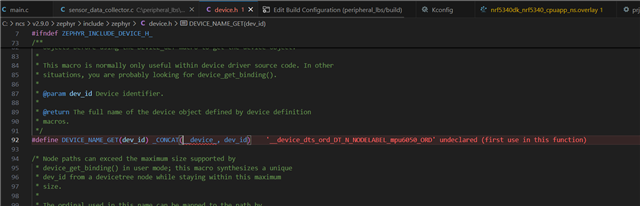

Interfacing mpu6050 with 52832 DK worked fine .
But when I used same sample code for 5340DK it produced errors .I configured device overlay file as below and build configuration accordingly . What are the other changes I should make.i found there is a problem with device overlay file, that didn't interface sensor (MPU6050)  properly with nrf5340DK ,Help me in rectifying it.
&i2c0 {
status = "okay";
mpu6050: mpu6050@68 {
compatible = "invensense,mpu6050";
status = "okay";
reg = <0x68>;

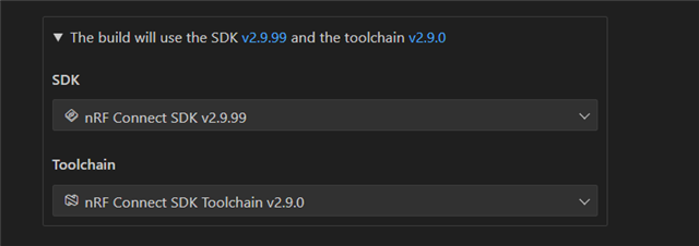

  • Hi
    Can you provide the SDK version you are using? It will also be helpful in you include the errors you are seeing and your prj.conf. Without any information it is not possible to recommend what you should try.
    Regards
    Runar
  • SDK version that I am using
    prj.conf

    Below is the error that I am getting in device.h file

  • Hi and thanks for the patience, is has been vacation time here in Norway
    Could you trying using NCS 2.9? We don't recommend using upstream Zephyr
    It would also be good if you can provide the overlay for the board and any error you are seeing.
