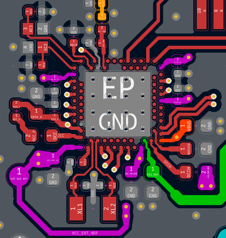

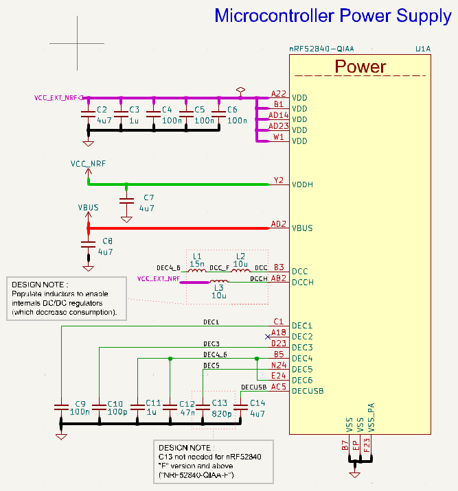

I'm using an nRF52840 on a custom board operating in high voltage mode, powered either by a LiPo battery or USB. The design follows configuration 4 from the nRF52840 reference designs.
To optimize current consumption, I’ve populated inductors for the REG0 and REG1 stages to enable the corresponding DC/DC converters. While enabling the second-stage DC/DC regulator (via NRF_POWER->DCDCEN = 1) successfully reduces current consumption, enabling the first-stage regulator (via NRF_POWER->DCDCEN0 = 1) unexpectedly increases it. I assumed that enabling both DC/DC regulators would provide the best efficiency, but my measurements suggest otherwise. Using an LDO for the first stage and a DC/DC for the second stage seems to yield the best results. Is this behavior expected?
