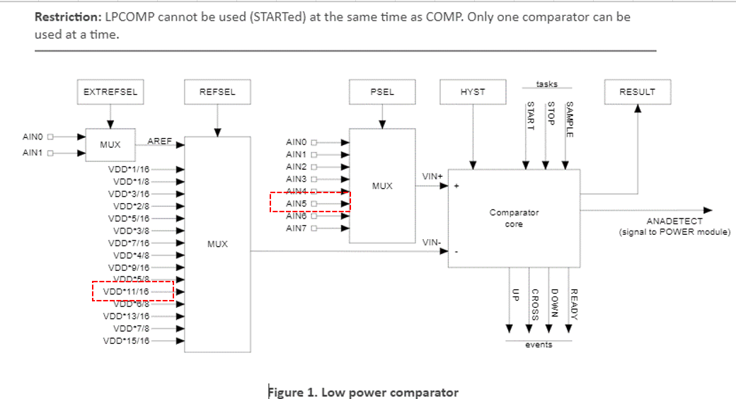

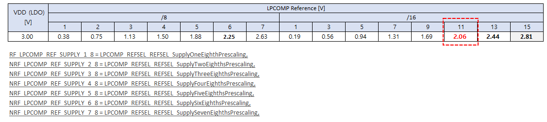

- Question 2)  The reference voltage setting of lpcom does not match the calculation

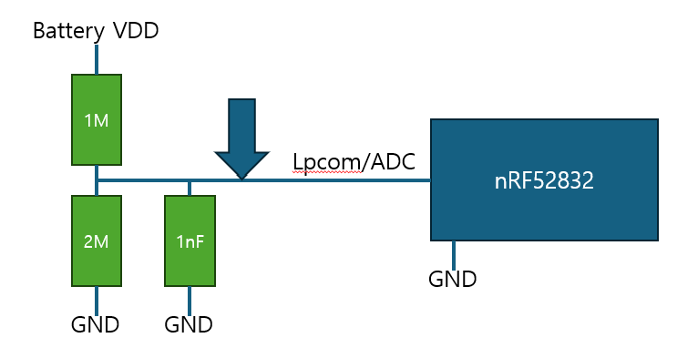

* Additionally, there are five products with identical circuitry and SW configurations, but with different PCB patterns.
However, this issue only occurs in one of the five products. The only difference is the PCB pattern.
The PCBs with the pattern differences are located at 1M and 2M, and the pattern distance between the 1nF resistor and the ADC port is approximately 15cm. (The lines indicated by the arrows in the image below.)
However, the four PCBs that are functioning normally are almost directly adjacent.
Could this be the cause?

    What I'm suggesting is that you decouple the LED from your debugging as it introduces other dependencies. Instead use the log module or just measure directly on a GPIO.
    pkr2258 said:
    I'm experimenting with a separate, precise external DC power source (instead of a battery).
    I switched to the ADC mentioned above, and measured the voltage across the 1M and 2M resistors when the voltage was normal and when it wasn't. The results were nearly identical.
    By any chance, are you saying that I should try to adjust the voltage by directly connecting it to the lpcom terminal?
    Yes, I'm suggesting that you circumvent the external LDO as well, connect VDD to port 1 of supply and then connect AIN to another supply and see if your code logic behaves as expected when VDD is decreased.

    * original composition
    * test configuration
    - When configured as shown below, it operates properly at normal voltages.
    - It's not a problem with the open circuit, 1MΩ. Replacing it and measuring it again revealed it was normal.
    Looking at the results above,
    is there a problem with the input impedance of the nRF52832's lpcom?
    Damage caused by static electricity or other factors, such as careless handling.
    I haven't tried swapping the chips in the nRF52832 chipset between a good and a defective one.
    I'll try it and post the results.
    I did some additional experiments
    I tried connecting jumper wires in parallel to the existing pattern.
    But the problem was not solved
    This time, I cut the pattern like the image below and tested it, but the problem was not solved.
