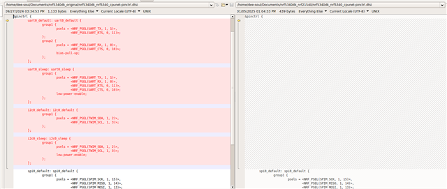

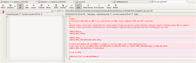

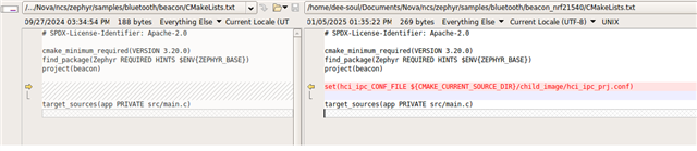

I modified ncs/zephyr/samples/bluetooth/beacon sample to include hci_ipc_prj.conf file for MPSL Configurations for TX Gain setting and such as follows:

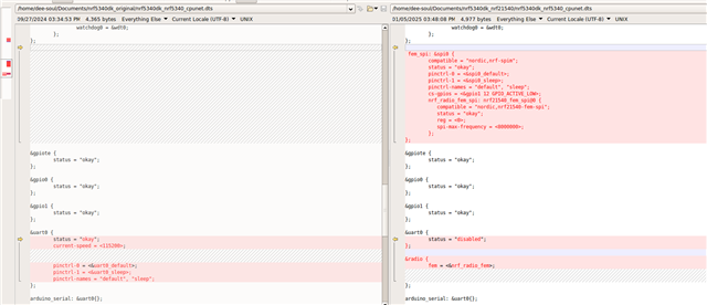

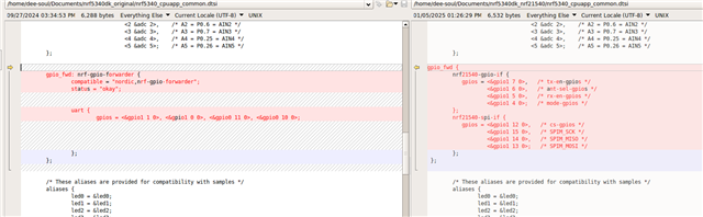

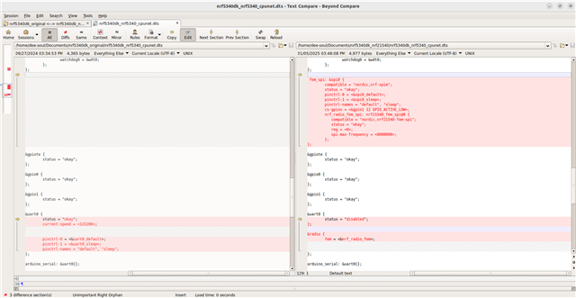

I also modified the nrf5340dk board files to configure nRf21540 FEM for SPI+GPIO as follows:

I was expecting to see build/hci_ipc/ folder with build/hci_ipc/zephyr/.config file with all MPSL settings, but I do not see the file.
When I test the build as well, I see beaconing happening from nRf5340 DK itself and nRf21540 is not being used at all by netcore.
What do I do to get the MPSL settings in .config file in hci_ipc build and to actually get nRf21540 be controlled by netcore of nRF5340?

    A) parent-child image with modified device tree files:
    Ok yes I tried with --no-sysbuild.
    I was also adding the hci_ipc_prj.conf to app image Cmaklists instead of net image cmakelists file.
    I added it to samples/zephyr/bluetooth/hci_ipc, as the beacon sample was using this for netcore image.
    Then it showed me the hci_ipc/zephyr/.config file with correct MPSL settings and such as per the document.

    2. I ultimately want to use nRf21540 chip on our custom board. So we will not be using nRf21540 EK as is, but will need modified config. In this case, the device tree changes will still be needed right?
    Not sure what to do next to get the nRF21540 to work.
  • Hi
    1.Work in progress from my side
    2. This is correct, when you are using a custom board with a non ek then you will need to create an overlay for the board where you have added the necessary devicetree entries. Please see Enabling FEM support (adding it just in case, you have already enabled the Kconfig options).
