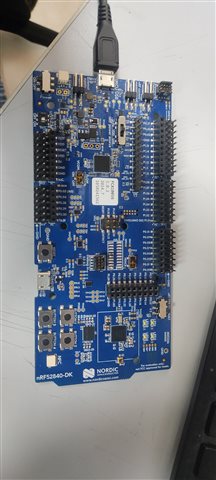

I have an NRF52840 DK (3.0.2) board, but it is not working. The USB port is not detected. When I power it through USB, the debug LED (LED5) turns on and then off. On the SoC side,
LEDs 1, 2, 3, and 4 are dimly lit. Please help and provide a proper solution.

    It also looks like this DK has been modified with extra pins on the sides, make sure that there is no shorts VDD and GND or 5V or GND or any of the GPIO pins.
    Jonathan

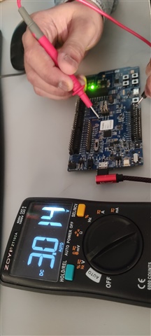

  • I also tried changing the USB cable, but it is still not working.
    I checked by turning off the VEXT pin, but it didn't work either.
    I have checked the 5V and GND, and they are fine. I also checked the nearby pins where I connected external components, and there are no shorts anywhere.

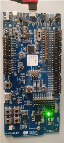

  • I am facing the same issue. The LED5 on my DK board blinks for a short time and then turns off. Please find the attached video.
  • Can you use the Debug out port from the other DK to program the nRF52840 on the DK that does not work as expected?
    You can use a 10-pin ribbon cable connector here and try to program the nRF52840, if there are no issues with that then its likely that there is something wrong with the debugger chip and circuitry.
