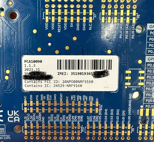

I followed the instruction (https://docs.nordicsemi.com/bundle/ncs-2.5.0/page/nrf/samples/cellular/lwm2m_client/sample_description.html) to build and run on my nRF9160DK, but got this error.

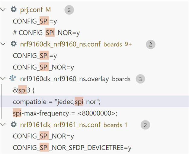

[00:00:00.255,340] <err> spi_nor: Device id 00 00 00 does not match config c2 28 17
Do you have any idea how to solve it?
board: nrf9160dk
SDK: v2.5.0
lwm2m server: Leshan demo server
DTLS
nb-iot (China Mobile Hong Kong)
no sensor, no GNSS
config files: prj.conf , overlay-nbiot.conf , overlay-lwm2m-1.1.conf , overlay-dtls-cid.conf
