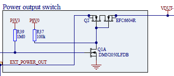

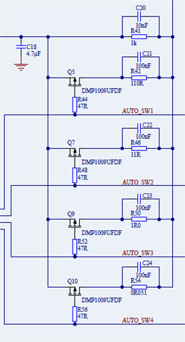

    One more question, I've been using the tool quite a lot and on this last project where I've a inboard dc-dc boost, the tool was reading averages currents of 0.6A with peaks of 1.5A.
    The power profiler is now reading an average current of 0.42uA without any load. Does this means that the power profiler is broken? I was using source mode with 5000mV... I thought that there was some protections to avoid this...
    Is it possible to fix it? What components should I be looking for replacing?
    Fernando Fontes
  • There is no physical protection that I see. Max continuous current in Ampere Mode is 1A, and in Source Mode only 600mA; this would imply the sense resistors and FETs are rated to at least 1A. Maybe test the resistance of the 0.051Ohm (0r051) resistor R54 and that Q3 and Q10 still work. The schematics include component locations.
    Also note "If the PPK2 is operating in Source Meter mode and the DUT can draw more than 400 mA, an extra external USB power supply that can deliver 1 A or more is recommended" which may also be an issue.
