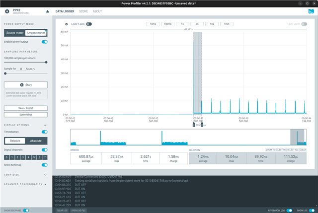

  • Was able to test a sample on the DK and our board
    1) DK, Pretty quick most of the time, did see a couple instances where it took about 500ms but that was about 1 in 10 times. Most times it was pretty quick
    2) Same Sample on our board, seems to consistently take about 1 second or more to first advertisement. This is much lower than 2.5 seconds but I'm guessing the bootloaders also add some overhead in that scenario.
    Do you think the Power/Clock subsystems are taking much longer to stabilize on our board? Also how to lower the time taken by the bootloaders themselves?

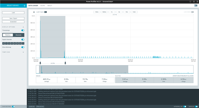

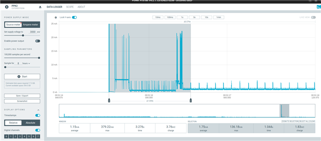

    Also does the current draw pattern suggest anything for our board for why it's taking so much longer.
  •    Did some more experiments and I see this for time taken at each of the stages. NSIB starts executing immediately and seems like it's MCU boot which is taking quite a while to find the image and jump to the image. This is on our board with the production firmware.
