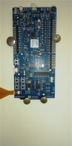

    LD5 on the board blinks.
    I do not know how to check if the DK enumerates as a mass storage device named 'Jlink' when I plug in the USB.
    Thanks again for confirming. If LED 5 is blinking it indicates that there is no data communication between the Segger IC and PC. Please try with another USB cable and different ports on the PC. Please also post a picture of the board so I can check if all the switches are in their default positition.
    The board should show up as a  removable storage device like a USB memory stick in Windows.
    I tried two different USB ports - but problem persists.
    When I plug my DK into the USB port - it does not show as a removable storage device in Windows. I attach a screenshot of the Windows File manager that only shows: "Windows SSD(C:)" under "This PC" - and no removable storage.
    As requested, I attach a picture of my nRF52840 DK board.

    Those thumbtacks look like they might be conductive.? I'm also wondering if you have any other USB cables you could try. I've seen quite a few cases where the cable itself turned out to be the culprit.
    As advised, I tried to use another USB cable - and this resolved my problem!
    I am now able to communicate from the nRF Connect for Desktop with my Nordic nRF52840 DK development kit.
