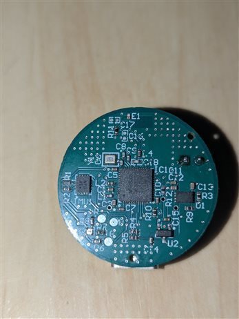

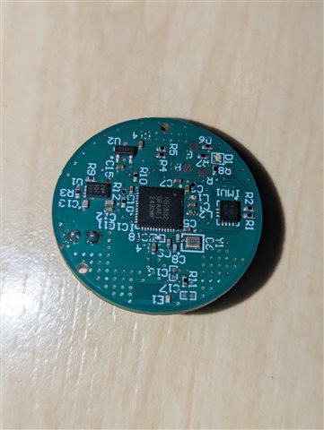

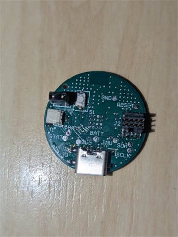

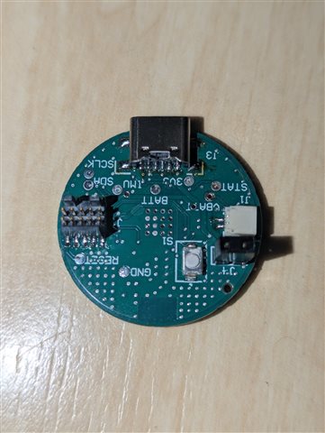

I'm trying to flash a custom board (schematics in this ticket - Schematic/Layout review request) using a Jlink EDU mini and keep running into an error message saying it's failing to read or erase memory. I've seen suggestions on other posts that running nrfjprog --recover can remove the read protection mechanism, but when I ran that (with --log, which I've attached) it also failed.

    If the nrfjprog --recover or flash commands doesn't work I don't think this is due to the board files, since it doesn't seem to get a communication up and running in the first place. Did these command work at all at one point, and does the hardware work as expected on your end? If not, I would recommend checking your HW to make sure that all the components are soldered on correctly and that all component values are correct. Do you have an image of the board you're trying to flash?
