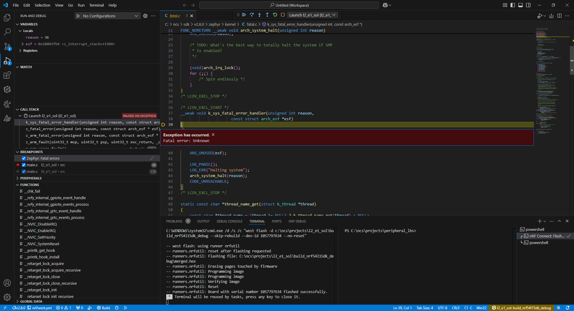

Cannot debug BLE Fundamentals examples with VS Code and nRF54L15DK
I am currently evaluating the new nRF54L15 DK development kit.
I installed VS Code v1.96.4 with nRF Connect for VS Code Extension Pack v2024.9.5. I am currently using SDK and toolchain v2.8.0 for my tests.
I was able to correctly download, compile and debug few example applications from the SDK like the 'blinky' app and the 'peripheral_lbs'.
Then I tried to do the same with examples provided in the BLE Fundamentals software pack (i.e bt-fund-main\v2.8.x-v2.7.0\l2\l2_e1_sol)
With 'l2_e1_sol' example app I am able to correctly compile and flash to the board (the code is executed like a charm); but when I try to start a debug session, an exception immediately occurs in Zephyr kernel and the debugger never jump into the main.
Is there any extra config to set to correctly debug the BLE Fundamentals example apps on nRF54L15 DK ?

    Thanks for the hints. CONFIG_LOG=y is enabled by default in the 'l2_e1_sol' example. Indeed, when I look into the log (refer to the print screen below) I realize that the debugger is executing the entire code. I don't know why it doesn't halt at the start of the main function or any breakpoints I place inside while it works with the 'blinky' app.
    This is quite strange since the same code can be correctly debugged on a nRF52840DK board.

    Please try to continue execution (click the play button) and see if you get the crashlog from the error handler in the terminal. This should provide more information of what kind of fault it is and where it occurred.
    Vidar
  • Hi Vidar,
    I continued execution as you mentioned. Before, I set CONFIG_LOG_DEFAULT_LEVEL=4 to log a maximum of information.
    I copied below the DEBUG CONSOLE and TERMINAL outputs.
    On the play button press, no more information is logged in the TERMINAL. Concerning the DEBUG CONSOLE I highlighted in yellow the last information logged before continuing debug.
    Hope it will help to find the root cause.
