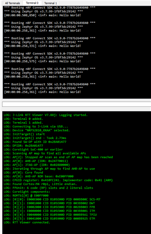

    You are using NCS version 2.0.0? It is very old.

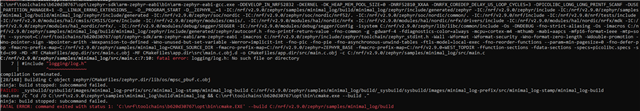

    I have tried to reproduce the minimal_log.zip on NCS version 2.9.0. Initially it shows there is no file like logging/log.h
    This is because there is no use of ''#include "logging/log.h" in current NCS version. The include statement for public zephyr headers has changed what was on NCS v2.0.0.
    The proper way to include the logging header in NCS 2.9.0 is:
    Then it worked as expected.
    Have you set the target device properly? Which version of RTT viewer you are using?

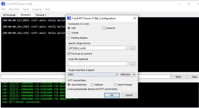

  • I tried your sample, and it worked on the nrf52832 DK for version v2.9.0 with some modification of the header file. That I mentioned on my previous reply.
    Now I have tried this on v2.0.0 as same as you. It worked (for old version there is no error related to log.h file, so no modification was needed).
    below is my configuration of RTT viewer.
