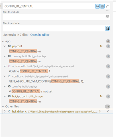

I am using the nrf5340 and attempting to enable a BLE connection on the board with 2 clients simultaneously.
The issue I'm encountering is that after advertising the device, both clients can see it. However, after one client connects, the second client can no longer connect. In a subsequent scan, the second client cannot find the advertising device.
As a workaround, re-advertising the device allows the second client to connect. But is it possible, in principle, to connect both clients one after the other within the same advertising window? Is this supported at the infrastructure level?
