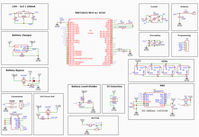

NRF52832 Schematic Review
As the title suggests, I'd like some help reviewing my schematic for a 52832 pcb. I have tried to stay as close as possible to the DCDC reference design.
Some notes on the uncommon parts:
- The STAT output on the battery charger is open drain or high Z
- The LED pin (LED data in) is not tied to the LED supply voltage
- All non-MCU supporting parts are moved over from a confirmed working design that was using an Espressif chip
