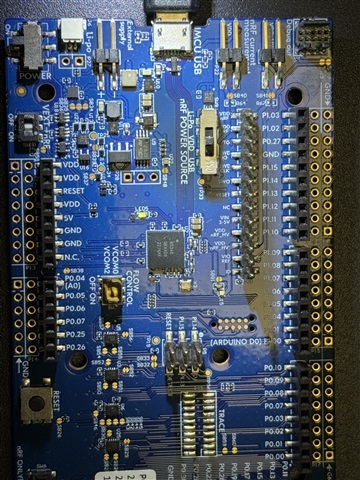

  • Thank you so much for your reply!
    Yes, it is brand new, so that I'm sure the SB40 SB54 SB55 are connected. I have anther new board and it can be flashed successfully.

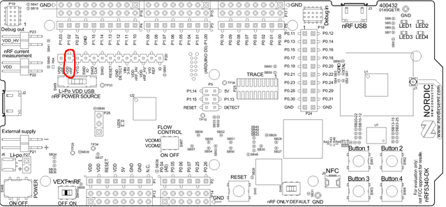

  • Can you measure the VDD_nRF' voltage on this pin:
    It should be 3V.
    Can you try is to supply the nRF5340 using the second USB connector in addition to the debugger USB connector. To do this you need to switch the power source to USB using switch SW9.
