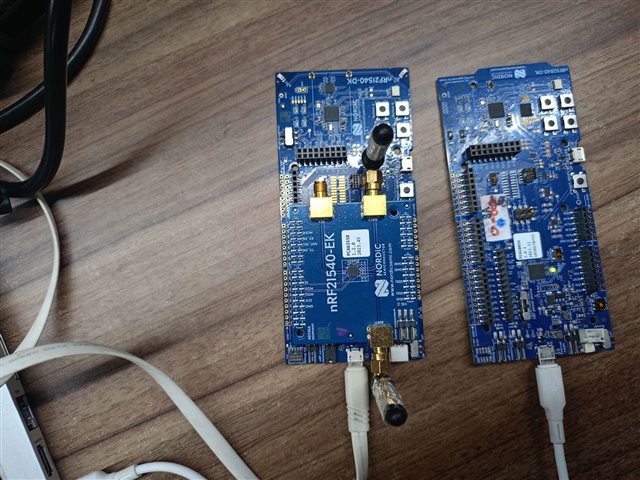

  • I tested the radio functionality using two boards:
    • Device A: nRF21540DK
    • Device B: nRF52840-DK
    Test Setup
    Without FEM (nRF21540-EK)
    I flashed the radio test example on Device A and the RSSI viewer program on Device B.

    Note: Set up env is also added.
    And in radio test documentation (https://docs.nordicsemi.com/bundle/ncs-2.9.0/page/nrf/samples/peripheral/radio_test/README.html#testing), it explains about two ways of radio tetesting. Im using RSSI viewer app to test the tx power. But the app has configurable levels only from -110 to -20dbm.  How to verify the FEM amplifier with +21dbm settings using RSSI viewer app?
  • Thanks for the picture, this clears thing up for me. The nRF21540EK is mounted on the nRF21540DK. The nRF21540DK already have a nRF52840+nRF21540 so there is no need to add the nRF21540EK on top of it. The EK is intended to be used with other development kit if you want to use a FEM with for example the nRF5340.
    When using the nRF21540DK you don't need to modify the device tree. The board files for the nRF21540DK already have the correct device tree node for the nRF21540, just build for the nrf21540dk/nrf52840 target.
    The RSSI viewer app can't really be used for measuring the output power, but you can use it to see if the FEM is actually working, as you will se a higher RSSI when using the nRF21540DK vs a nRF52840DK.
    To use the nRF21540EK with a development kit you also need a MXHT83QE3000 cable to connect the RF output of the development kit to the TRX connector on the EK.
