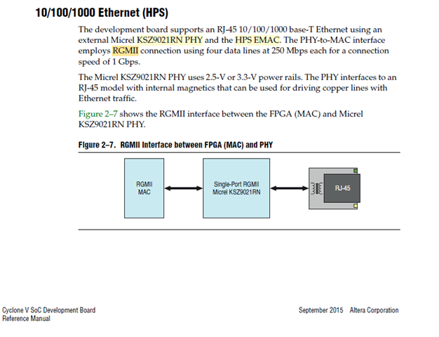

I have tried a lot of other things. For example I tried to enable gmac1 and disable gmac0 or disable both but without success. I had seen the approach with the own .conf and the .overlay file several times (e.g. for a STM32). So I think my approach is correct, but no network interface is recognized (Ethernent). I hope that someone sees my mistake and can help me. I would be very grateful for that. Finally, I'll insert a small screenshot from the documentation showing which Ethernet interface I'm using:

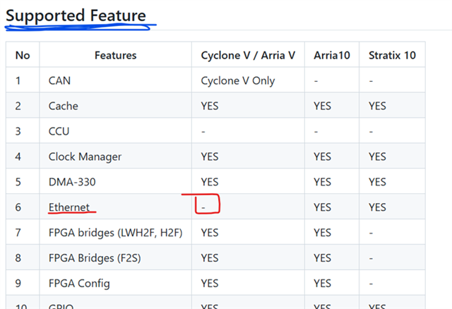

  • Another Input: in ...\zephyrproject\zephyr\drivers\ethernet\eth_cyclonev.c there is the following content:
    Driver specifically designed for Cyclone V SoC DevKit use only.*
    based on Intel SOC FPGA HWLIB Repo
    github.com/.../intel-socfpga-hwlib
    And in the git-repo there is the folling Table:
    Therefore i got errors, that the "properties" phy-mode isn't define, so have to do the following:
    --> in ...\zephyrproject\zephyr\dts\bindings\ethernet\snps,ethernet-cyclonev.yaml
    --> i had to add the property phy-mode myself
    --> so what is the message that the devoloper of this code wanna say me? I dont need an overlay-file? or i dont need to mention phy-mode and mdio? But it doesn't work eithter...
    Maybe zephyr doesen't support Internet/Ethernet Connecetion with this board. The necessary files are there, but not all of them i think. For Example, the following files exist:
    **--> ...\zephyrproject\zephyr\drivers\ethernet\eth_cyclonev.c
    --> ...\zephyrproject\zephyr\drivers\ethernet\eth_cyclonev_priv.h
    --> ...\zephyrproject\zephyr\drivers\ethernet\phy_cyclonev.c
    --> ...\zephyrproject\zephyr\drivers\ethernet\Kconfig.cyclonev**
