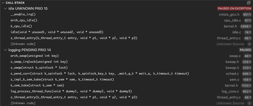

I am trying to debug an application in VS Code for the nRF52840 DK in the nRF Connect SDK.
After starting debugging, I immediately get this error: "Exception has occurred. Debugger was unable to continue the process".
This occurs at line 951 of cmsis_gcc.h:
__STATIC_FORCEINLINE void __enable_irq(void)
  __ASM volatile ("cpsie i" : : : "memory");
When a breakpoint is placed before __enable_irq(void) is called, the above error occurs at line 73 in reset.S instead:
#if defined(CONFIG_DEBUG_THREAD_INFO)
    /* Clear z_sys_post_kernel flag for RTOS aware debuggers */
    movs.n r0, #0

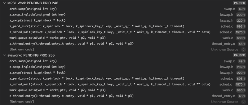

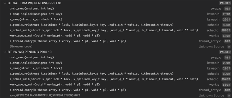

  • Hi Sigurd, here is the call stack when the exception happens:
  • Do you get anything printed in the log (either UART or RTT) about this exception ?

    __enable_irq () at /opt/nordic/ncs/v2.8.0/modules/hal/cmsis/CMSIS/Core/Include/cmsis_gcc.h:951
    951	  __ASM volatile ("cpsie i" : : : "memory");
    [New Thread 536899472]
    [New Thread 536880040]
    [New Thread 536899256]
    [New Thread 536899840]
    [New Thread 536890528]
    [New Thread 536890744]
    [New Thread 536890960]
    [New Thread 536899072]
    ERROR: Command aborted. See the output window for additional details.
