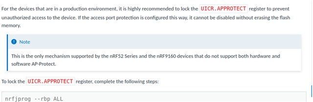

    4. Enable APPROTECT.
    Sigurd Hellesvik

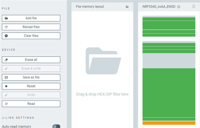

  • Here are the things I originally wanted to confirm:
    1. Can prj.conf be used for mass production?
    2. Will it be vulnerable to malicious access or modification?
    The APPROTECT feature you suggested seems to address the second issue. How can I enable APPROTECT?

    Yes. You are to only set one of the configurations.
    I previously tried using only CONFIG_NRF_SECURE_APPROTECT_LOCK, but it did not disable the Flash read function. That’s why I attempted to enable all three configurations.
    By the way, the SDK version I’m using is 2.9.0.
    I have previously tried using SB_CONFIG_APPROTECT_LOCK=y. Unfortunately, it resulted in a compilation error.
