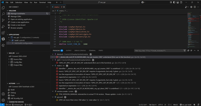

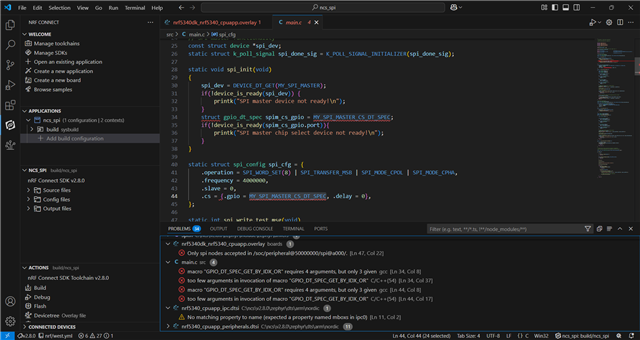

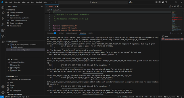

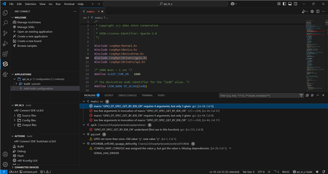

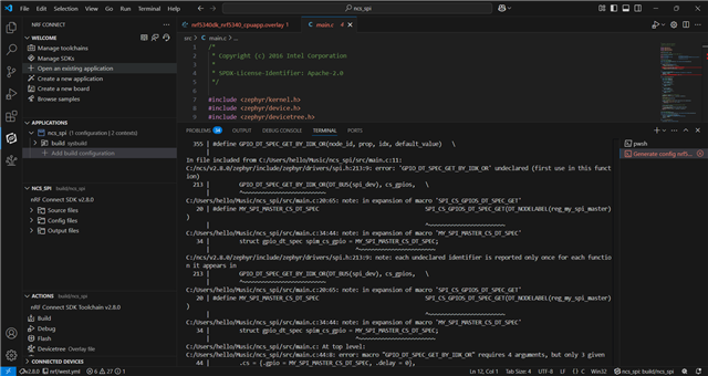

Hi, while compiling ncs-spi-master-slave-example , I am getting below errors
In function 'spi_init':
C:/Users/hello/spi/src/main.c:34:8: error: macro "GPIO_DT_SPEC_GET_BY_IDX_OR" requires 4 arguments, but only 3 given
34 | struct gpio_dt_spec spim_cs_gpio = MY_SPI_MASTER_CS_DT_SPEC;
In file included from C:/Users/hello/spi/src/main.c:11:
C:/ncs/v2.8.0/zephyr/include/zephyr/drivers/spi.h:213:9: error: 'GPIO_DT_SPEC_GET_BY_IDX_OR' undeclared (first use in this function)
213 | GPIO_DT_SPEC_GET_BY_IDX_OR(DT_BUS(spi_dev), cs_gpios, \
C:/Users/hello/spi/src/main.c:44:8: error: macro "GPIO_DT_SPEC_GET_BY_IDX_OR" requires 4 arguments, but only 3 given
44 | .cs = {.gpio = MY_SPI_MASTER_CS_DT_SPEC, .delay = 0},
C:/ncs/v2.8.0/zephyr/include/zephyr/drivers/spi.h:213:9: error: 'GPIO_DT_SPEC_GET_BY_IDX_OR' undeclared here (not in a function)
Is it related to sdk version? Can anyone help to resolve ?

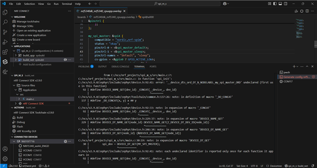

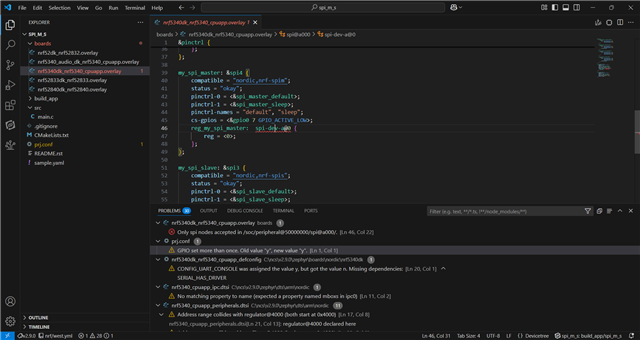

  • Hi, We want a design where we want use 2 spi buses for 4 slaves.
    &pinctrl {
    	spi_master1_default: spi_master1_default {
    		group1 {
    			psels = <NRF_PSEL(SPIM_SCK, 1, 15)>,
    					<NRF_PSEL(SPIM_MOSI, 1, 13)>,
    					<NRF_PSEL(SPIM_MISO, 1, 14)>;
    	spi_master1_sleep: spi_master1_sleep {
    		group1 {
    			low-power-enable;
    	spi_master0_default: spi_master0_default {
    		group1 {
    			psels = <NRF_PSEL(SPIM_SCK, 0, 8)>,
    					<NRF_PSEL(SPIM_MOSI, 0, 9)>,
    					<NRF_PSEL(SPIM_MISO, 0, 10)>;
    	spi_master0_sleep: spi_master0_sleep {
    		group1 {
    			low-power-enable;
    &gpio0 {
    	status = "okay";
    &gpio1 {
    	status = "okay";
    &spi4 {
    	status = "okay";
    	pinctrl-0 = <&spi_master1_default>;
    	pinctrl-1 = <&spi_master1_sleep>;
    	/*cs-gpios = <&gpio1 12 GPIO_ACTIVE_LOW>,
    			   <&gpio1 10 GPIO_ACTIVE_LOW>;
    	reg_spi_master1: spi-dev-a@0 {
    		reg = <0>;
    		compatible = "spi-device";
    	reg_spi_master2: spi-dev-a@1 {
    		reg = <1>;
    &spi0{
    	status = "okay";
    	pinctrl-0 = <&spi0_default>;
    	pinctrl-1 = <&spi0_sleep>;
    	/*cs-gpios = <&gpio0 11 GPIO_ACTIVE_LOW>,
    			   <&gpio0 19 GPIO_ACTIVE_LOW>;
    	reg_spi0_master1: spi-dev-a@0 {
    		reg = <0>;
    	reg_spi0_master2: spi-dev-b@1 {
    		reg = <1>;
    When configuring like above in overlay
    In main
    #define SPI1_MASTER                         DT_NODELABEL(spi4)
    #define SPI0_MASTER                         DT_NODELABEL(spi0)
    #define SPI0_MASTER_CS_GPIO                 DT_NODELABEL(gpio0)
    #define SPI1_MASTER_CS_GPIO                 DT_NODELABEL(gpio1)
    const struct device *spi_dev;
    const struct device *gpio_dev;
    struct spi_config spi_cfg={
    .operation = SPI_WORD_SET(8) | SPI_TRANSFER_MSB | SPI_MODE_CPOL | SPI_MODE_CPHA,
    .frequency = 4000000,
    .slave = 0,
    void Init(uint8_t slave)
            spi_dev = DEVICE_DT_GET(SPI0_MASTER);
            gpio_dev = DEVICE_DT_GET(SPI0_MASTER_CS_GPIO);
            spi_cfg.cs.gpio.port=gpio_dev;
            spi_cfg.cs.gpio.pin = 11;
            spi_cfg.cs.gpio.dt_flags = GPIO_ACTIVE_HIGH;
    Giving error only for SPI0_MASTER. when all are SPI1_MASTER, it is building
    error: '__device_dts_ord_105' undeclared (first use in this function); did you mean '__device_dts_ord_15'?
       92 | #define DEVICE_NAME_GET(dev_id) _CONCAT(__device_, dev_id)
    C:/ncs/v2.8.0/zephyr/include/zephyr/toolchain/common.h:137:26: note: in definition of macro '_DO_CONCAT'
      137 | #define _DO_CONCAT(x, y) x ## y
    C:/ncs/v2.8.0/zephyr/include/zephyr/device.h:92:33: note: in expansion of macro '_CONCAT'
    C:/ncs/v2.8.0/zephyr/include/zephyr/device.h:229:37: note: in expansion of macro 'DEVICE_NAME_GET'
      229 | #define DEVICE_DT_NAME_GET(node_id) DEVICE_NAME_GET(Z_DEVICE_DT_DEV_ID(node_id))
    C:/ncs/v2.8.0/zephyr/include/zephyr/device.h:246:34: note: in expansion of macro 'DEVICE_DT_NAME_GET'
      246 | #define DEVICE_DT_GET(node_id) (&DEVICE_DT_NAME_GET(node_id))
    C:/Users/nrf_Projects/ad_spi/src/main.c:40:19: note: in expansion of macro 'DEVICE_DT_GET'
       40 |         spi_dev = DEVICE_DT_GET(SPI0_MASTER);
    C:/ncs/v2.8.0/zephyr/include/zephyr/device.h:92:41: note: each undeclared identifier is reported only once for each function it appears in
    In overlay file
    spi1_master:&spi4 {
    	status = "okay";
    		reg = <0>;
    		reg = <1>;
    In main
    #define SPI1_MASTER                         DT_NODELABEL(spi1_master)
    spi_dev = DEVICE_DT_GET(SPI1_MASTER);
    Giving below error
    error: '__device_dts_ord_DT_N_NODELABEL_spi1_master_ORD' undeclared (first use in this function)
    C:/Users/nrf_Projects/spi/src/main.c:40:19: note: in expansion of macro 'DEVICE_DT_GET'
       40 |         spi_dev = DEVICE_DT_GET(SPI1_MASTER);
    Can you once check above attached file??
    Is there any zephyr spi sample example for nrf5340 for multiple slaves?
    Thankyou

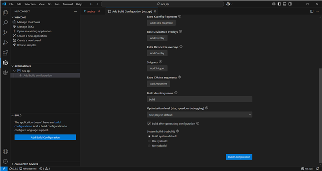

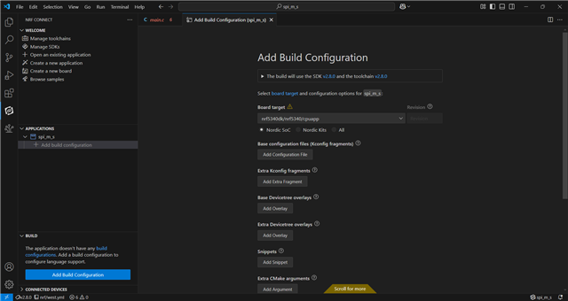

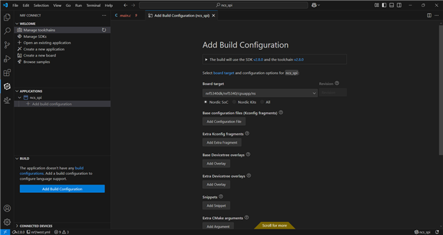

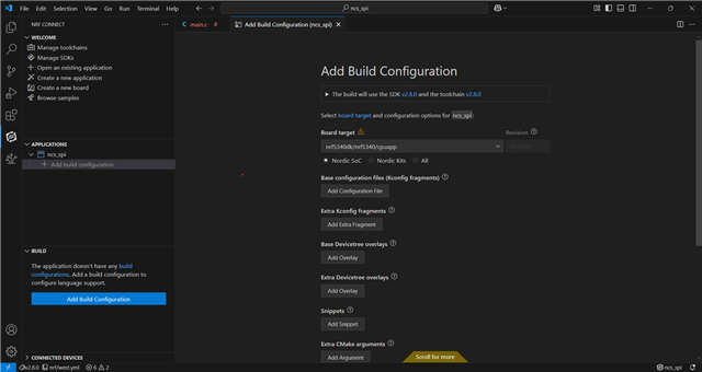

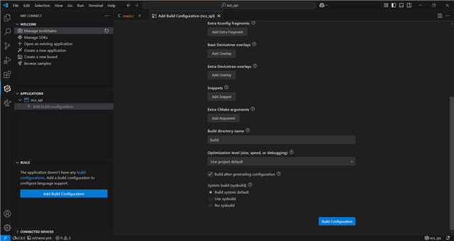

  • Hi,Here are the images of the building the sample
  • Ah, thank you for providing this. You're building for the /ns target of the nRF5340DK. Currently there are no board files for this within the board folder meaning that the SPI configuration is not set up for the build target you're trying to target
    Please try again with this target and let me know if this compiles
    Andreas
  • Hi, tried building with target nrf5340dk/nrf5340/cpuapp selected, still giving errors.

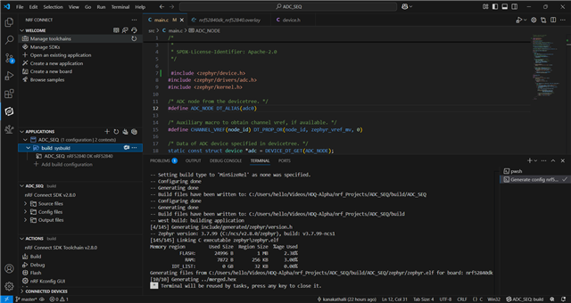

    Not able to build zephyr ADC examples also

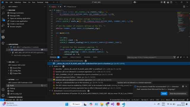

  • Hi
    Lets start with the ADC sample first. This sample work for at least the supported boards. Lets focus on the adc_sequence sample within zephyr/samples/drivers/adc.
    There are also no nRF5340 board support in the board folder of this sample. It works with any of the boards found within adc_sequence/boards, for instance with nrf52840dk/nrf52840 (below is a result with build from terminal and list of the boards found in the boards folder of this sample. The same can be stated for the VS Code extension).
    If you remove and build for the nrf52840dk, do you see the error as you previously did? If you do, then I believe there is something wrong with your installation. Could you 1: generate support information from vs code by opening command pallette in VS Code, i.e
    1. Open VS Code
    2. Open command pallet by pressing ctrl+***+p
    3. search for "generate support information"
    4. Select it and press enter and upload the information here
    If we get this working, then we can go back to the spi master sample from too1's git repo
    Andreas
    adc_sequene sample is building with target nrf52840dk
    nrf connect generate support information is as below
    Thats good to hear. This indicates that the SDK is properly set up and that building an in-tree application works.
    Everything here looks fine and your setup is as good as identical to mine.
    W.r.t the spi sample.
    Here's a new, unmodified version of the same sample from here https://github.com/too1/ncs-spi-master-slave-example/tree/master
     spi_m_s.zip
    I've verified with multiple colleagues that this sample builds out of the box for the following configuration
    • NCS 2.8.0
    • nrf5340dk/nrf5340/cpuapp
    • with and without sysbuild
    I see that you've previously built the SPI sample from c:\Users\hello\Music\ncs-spi-master-slave-example-master. Could you shorten the name of the sample and preferably place it closer to C:\? Windows has an issue with path length when building any project.
    Place the sample for instance within ncs/my_projects
    and build for the configuration I mentioned.
    Andreas
  • Built the sample for given configuration, still it is giving errors
  • I must admit I'm baffled. I can't see anything but there being something faulty with the installation or that something has been modified in the SDK
    1. Could you try with a different work station
    2. Could you uninstall NCS and all tools completely and reinstall them per https://docs.nordicsemi.com/bundle/ncs-latest/page/nrf/installation/install_ncs.html
    I've tried building with multiple different work stations myself, as well as different OS and none give the faults you're seeing. Since you were able to build the adc sample out of tree, I am expecting you to be able to build the zip I sent you with the exact same steps as you successfully built the adc sample with.
    Andreas

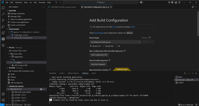

  • Hi Andreas,
    1. Tried with a different pc where ncs2.6.1 and toolchain 2.7 were installed, it is building.
    2.Reinstalled ncs  and all tools again.
       ncs 2.9
      tool chain 2.9. Able to build the sample.
    But in both the cases it is giving error related to overlay file
    And also, do we have to add different overlay for application and network core?
    When building the same sample for configuration nrf5340dk/nrf5340/cpunet, it is giving errors
    Thank you
       ncs 2.9
    Great! Glad to hear that
    To be frank, the Problem-tab is quite misleading in some cases and might through warnings and red-underline some issues that is not there at all. But if I would guess if the error is a real one, I would guess that it is because some naming has changed between v2.5.1 (where the sample was built) and v2.6.1. On second thought, it might actually be due to hardware model changes https://docs.nordicsemi.com/bundle/ncs-latest/page/nrf/releases_and_maturity/migration/migration_hwmv2.html
    For the 5340 you only need to have a board file for the cpuapp and the non-secure version of cpuapp, i.e cpuapp/ns unless you have custom netcore firmware with custom board changes. As it is by default: The build system will add the companion components it needs to add for the netcore if you add the relevant configurations to prj.conf or sysbuild.conf and sysbuild/<your_companion_image>.conf and .overlay. See https://academy.nordicsemi.com/courses/nrf-connect-sdk-fundamentals/lessons/lesson-3-elements-of-an-nrf-connect-sdk-application/ for a great explanation of the components in an NCS application and https://academy.nordicsemi.com/courses/nrf-connect-sdk-intermediate/lessons/lesson-8-sysbuild/topic/sysbuild-explained/ for the sysbuild expandation
    This is roughly the same errors that you got previously, where the build fault log states that it can't find the items in main.c that is specified in <your_build_target>.overlay, since there are no nrf5340dk/nrf5340/cpunet overlay files that states that the various SPIM/S instances should be on the board.
    Let me know if this answers your questions!
    Andreas
