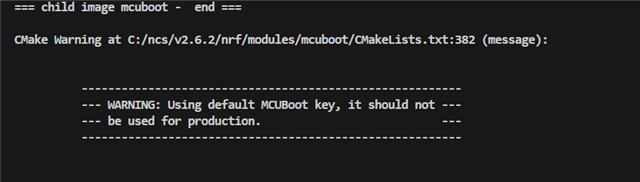

    And the warning is also here (meanwhile the path reported during bootloader child image build is correct):
    Anton
  • Hi Anton,
    It looks like setting the CONFIG_BOOT_SIGNATURE_KEY_FILE symbol in the parent image confuses the cmake build script for the signing mechanism (causes the key path to also include the path to the default key). Please try to only set the symbol in the mcuboot child image as shown below (same as in the devacademy course).
    if(DEFINED BOOT_SIGNATURE_KEY_FILE)
        set(mcuboot_CONFIG_BOOT_SIGNATURE_KEY_FILE
          \"${BOOT_SIGNATURE_KEY_FILE}\"
        set(hci_ipc_CONFIG_SB_SIGNING_KEY_FILE
          ${CONFIG_BOOT_SIGNATURE_KEY_FILE}
        message("Signing Key is applied: ${mcuboot_CONFIG_BOOT_SIGNATURE_KEY_FILE}")
    endif()
