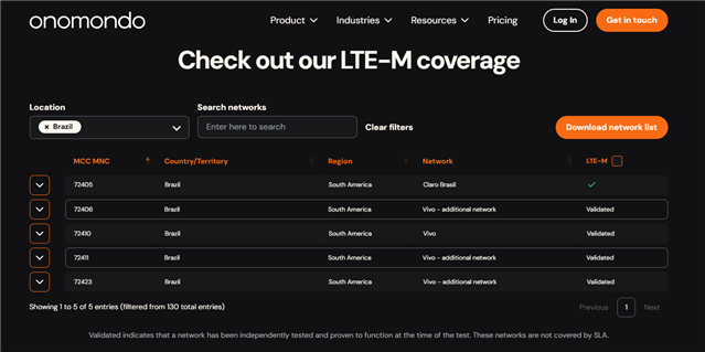

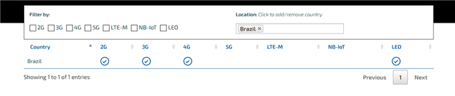

    What kind of SIM cards are you testing with? Did you test with both Wireless Logic and Onomondo?
    The Wireless Logic SIM does not seem to have coverage for LTE-M and NB-IoT in Brazil.
    Onomondo SIM should have some support for LTE-M
