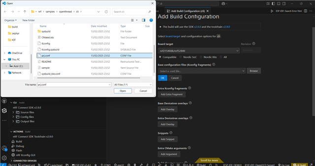

  • Hi Edvin, as i have no idea how can i build the cli sample code and generate a .hex file so i can flash into my dongle.
    the documentation shown is using the nrf52840 board but i am using the dongle instead so the setup is different.
    Additionally, i downloaded anotherthread cli zephyr
    but doesnt work though. Anyways steps to mitigate it?
    Ok, so the issue is not related to flashing, but to building, then.

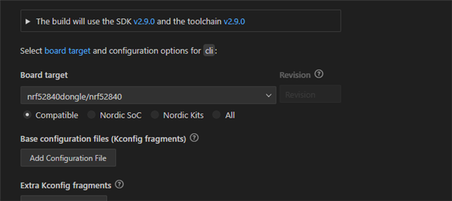

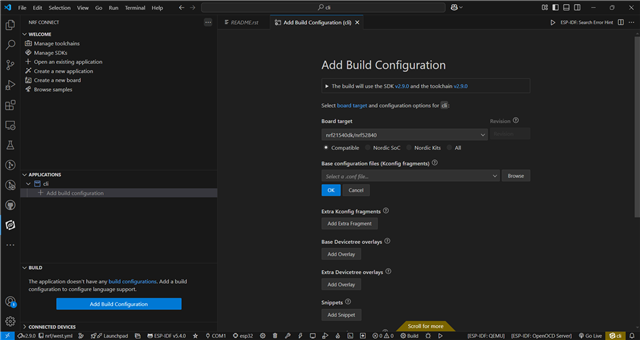

    You need to build for the correct board:

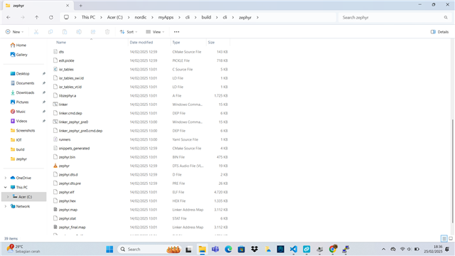

    Then it will generate the .hex file found in: build\cli\zephyr\zephyr.hex. Use this to program the dongle using nRF Connect for Desktop -> Programmer.
    When you insert the dongle, you need to put it in DFU mode. To do this, press the reset button while it is powered (not the big white button, but the gray one next to it). Then it should start blinking red, and it is ready to be programmed.

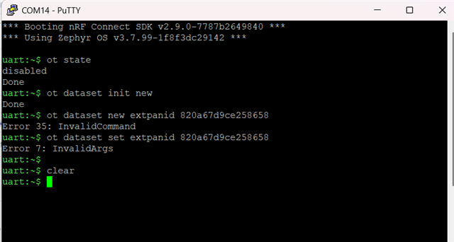

    Not sure what you mean by this, or what your COM14 - PuTTy is supposed to show. Did you get it working, or is that some 3rd party application?

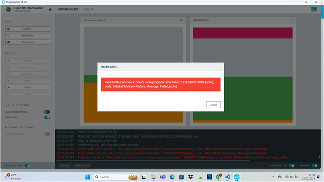

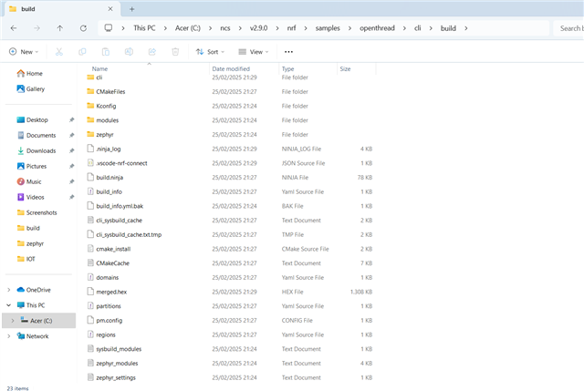

  • im not sure i am doing it correctly, i manage to build the sample openthread cli it generate a merged.hex (im not sure is the correct .hex file) then i try flashing into the dongle it shows the error as seen in the 1st picture log. for the base configuration setting i uses the prj.conf located at file C:\ncs\v2.9.0\nrf\samples\openthread\cli. Not sure which part when wrong?
    And u mention zephyr.hex? i dont get this part as the sample cli code is from openthread CLI as per from the NRF Connect SDK sample code though.
  • oh i think i manage to solve it! so sorry i didnt choose the board target as dongle thus it didnt generate a zephyr.hex file instead. Thank u Edvin.
